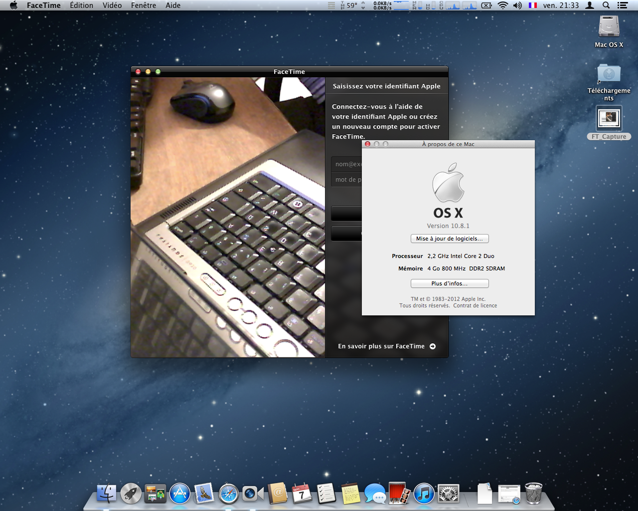

Administrators Hervé Posted September 7, 2012 Administrators Share Posted September 7, 2012 My Logitech C250 (P/N: V-U0003, P/N: 860-000180) works perfectly on a D630 nVidia 135m running ML 10.8.1 installed through myHack 3.1.2/EDP v4-r7 method. Macam not even installed. 1 Link to comment Share on other sites More sharing options...
