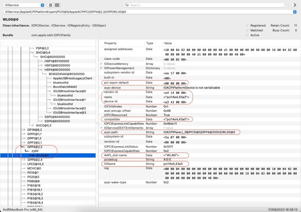

Koi Posted August 27 Share Posted August 27 macOS version: Ventura 13.3.1 CPU: AMD Ryzen 7 5800h Laptop model: Lenovo Legion pro 5 No wireless device found in Hackintool, but bluetooth is working good: EFI.zip Link to comment Share on other sites More sharing options...
Administrators Hervé Posted August 27 Administrators Share Posted August 27 You need to follow the required process for Broadcom BCM4350 cards as detailed here. But if the wifi card is not even detected, that probably won't do much good. Maybe hardware is faulty. Post a zipped IOreg extract taken from IORegistryExplorer. Link to comment Share on other sites More sharing options...
Koi Posted August 27 Author Share Posted August 27 Thank you for your reply, here is my ioreg link I'm not sure if the hardware is faulty, but wifi and bluetooth work fine on window Link to comment Share on other sites More sharing options...
Administrators Hervé Posted August 27 Administrators Share Posted August 27 Well, it sure is seen in IOReg: And, from what I see, you appear to inject suitable properties. Maybe be you ought to rename your ACPI device from WL00 to ARPT. See if that makes any difference. You could also try a different SMBIOS profile to see if it makes any difference though I should not think so. MBP13,x/14,x/15,x sure support the card normally. Link to comment Share on other sites More sharing options...
