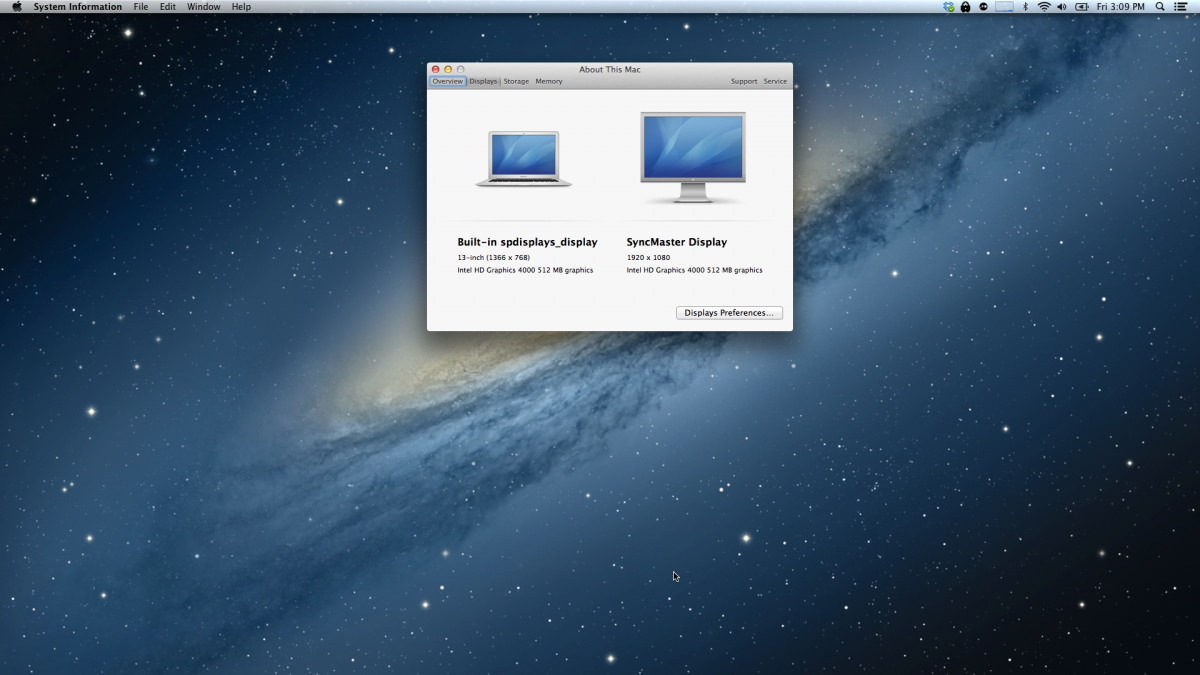

gohmac Posted May 1, 2013 Share Posted May 1, 2013 On 4/26/2013 at 1:21 PM, driedger said: Strange that the 3 of us all seem to have different results as far as the graphics go. Platform Id 3 or 4 would not enable accelerated graphics with the stock capri kext from 10.8, 10.8.2, or 10.8.3. Nsemenov's capri.kext enables the HD4000 on 10.8 and 10.8.3 for me without a string, and just by using GraphicsEnabler=Yes. Internal display and HDMI both work with this config. I have the i7 3520M processor, 1600x900 HD Plus Display, and 1 4GB stick of RAM. My system reports 384MB of video RAM. Malone, did your system ship with 16GB ram, or did you upgrade it? I would like to go to 16GB ram, but I've read conflicting reports that 16GB is only available through Dell Configuration Services? Hi. I used platform id4, via dsdt, the only one that worked. Then edit AppleIntel FramebufferCapri.kext. Now I'm able to get both HDMI and VGA ouput working though still working on changing the proper resolution. AppleIntelFramebufferCapri.kext.zipFetching info... Link to comment Share on other sites More sharing options...

gohmac Posted May 1, 2013 Share Posted May 1, 2013 What i meant was once you get your Intel HD4000 to work with the correct platform id, either with EFI injection or DSDT, the attached AppleIntelFramebufferCapri.kext that I've attached was hex-edited to enable VGA and HDMI output. Link to comment Share on other sites More sharing options...

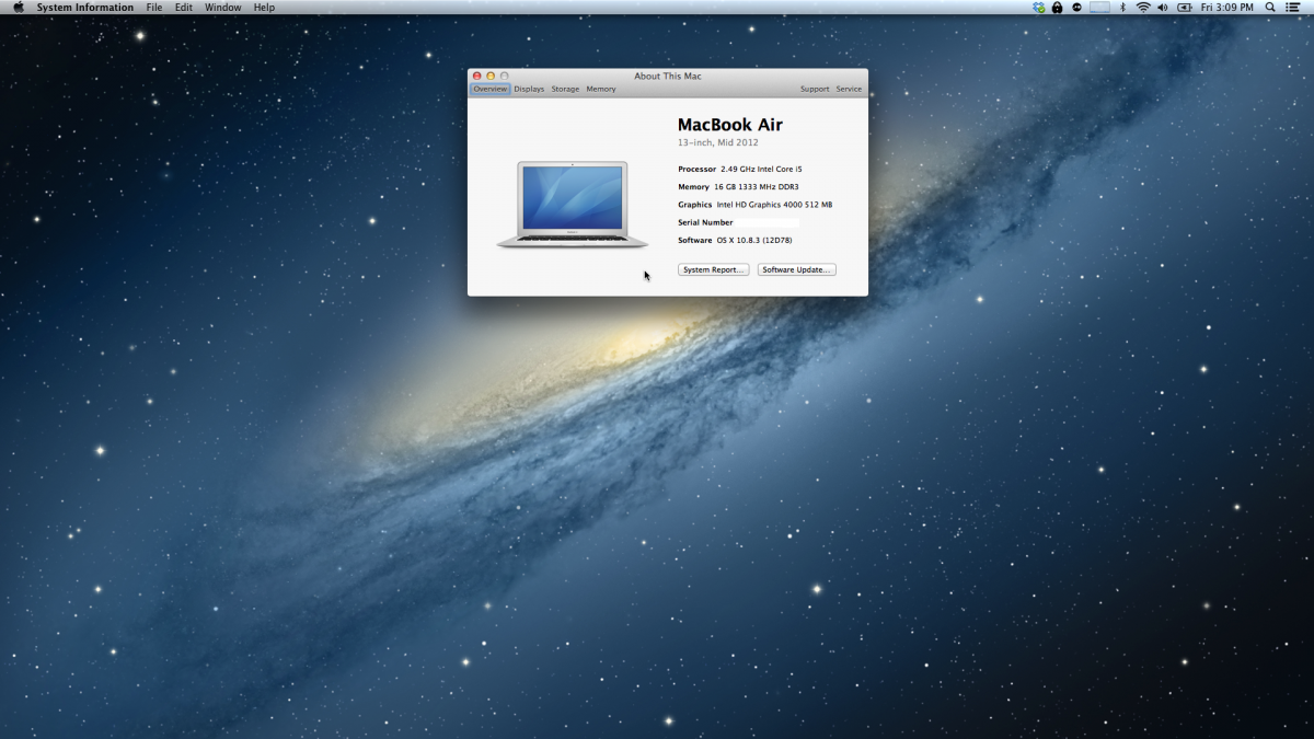

gohmac Posted May 6, 2013 Share Posted May 6, 2013 On 5/2/2013 at 8:50 AM, nsemenov said: There is no "correct" platform-id that would work OOB for me and some other folks. In theory 5430 that has BIOS hardcoded 64MB of stollen memory one must select from 2,3,8,9. In practice id=4 worked for me but it has only one pipe and supposedly can only work for screen mirroring (no screen extention) so I have not pursued this path. So my question remains what id have you used in dsdt or otherwise. So far is not clear what connection strings are working for you and how (mirror, extended desktop) My e5430 initially was using older BIOS version A07 and would only work with id platform 4 with no HDMI or VGA support but full QE/CI with 1600X900. Using the edited AppleIntelFramebufferCapri kext, I was able to have VGA and HDMI output with id 4 with mirror mode in single screen only. After upgraded the bios to A10, I was only able to boot to screen with id platform 8 with available graphics RAM of 384MB. With modified AppleIntelFramebufferCapri kext as outlined earlier in this post, I was able to use id platform 3 with reported available graphics RAM of 512MB. However, I still only have VGA and HDMI output in mirror mode which works with single screen at one time. I also need to change the resolution of the monitor to 1024X768 with SwitchResX otherwise the whole screen won't fit. Do you have any solution to have extended screen mode possible? Link to comment Share on other sites More sharing options...
