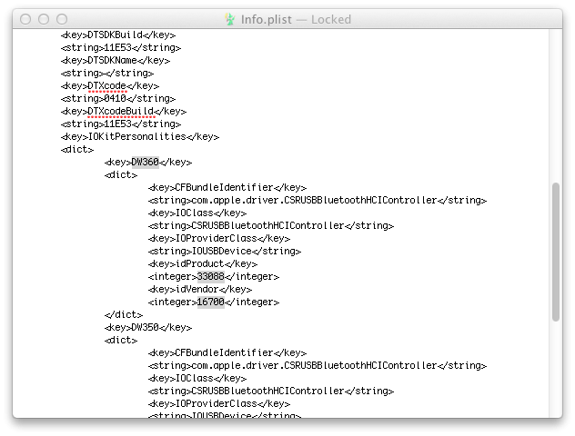

Re: Bluetooth, in Systems Information, you probably see your Bluetooth module listed in a similar fashion as below:
Take a note of the Vendor Id & Product Id. Convert these Hex numbers to Decimal. Then open up the contents of IOBluetoothFamily kext in /S/L/E and go to the PlugIns subfolder. If you have a CSR module, make a copy of CSRUSBBluetoothHCIController kext to your desktop, otherwise, check the other Controller kexts and do the same.
Open up the contents of that kext and, using your above Dec values, text edit the Info.plist file in a similar fashion as illustrated below, keeping only your particular module description in the file (no need for the others):
Move or copy the patched kext to /E/E, rebuild permissions and kext cache with myFix and reboot.
You should then obtain the missing BT On/Off option in the top bar scroll-down menu:
PS: These Bluetooth kexts appear to be different at each OS X mainstream version or even revision. A such, it's strongly recommended to do the same each time you update or install Mac OS X to ensure it'll work.
