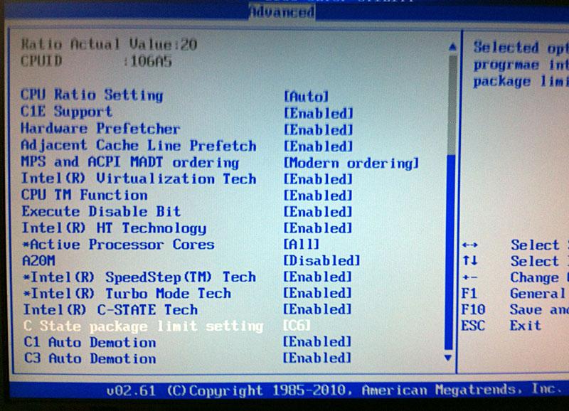

blackosx Posted May 12, 2012 Share Posted May 12, 2012 leomenassun said: My audio is enabled now, except my mic though it worked before with those extra kexts. Good to hear your audio is working. I don't use a mic here so I've never thought of checking for it. I'm sure it can be added - I guess the codec verbs need to be changed? I'm not very good at that but maybe I can have a look sometime in the future. Otherwise maybe somebody else might be able to help? leomenassun said: NO, I'm not happy. I'm afraid of damaging my buddy i7... :/ Ambient temperature here is around 20ºC, believe it or not! Well if you're positive the thermal paste has been applied (I know you said an engineer did it for you) then I can suggest only that you get a better aftermarket cooler and look at the airflow in and out of your case. Is the PC stuck in a corner somewhere, would moving it help? leomenassun said: Unfortunately, I didn't find in my BIOS the correct place to set C6 limit. It's not in the same key settings as C-State Tech! It only appears once Intel® C-STATE Tech is enabled. I see it here under: Advanced -> CPU Configuration If you want, I'll post a photo of my screen? leomenassun said: I run this command and got this message: 63 0 0xffffff7f8135e000 0x3000 0x3000 com.apple.driver.AppleLPC (1.5.8) . Does it means that the kext is loaded? Yes. leomenassun said: If it means, so the reason for Darwin Dumper has showed that it was not loaded might be because I hadn't done system modifications when I run it. Correct leomenassun said: I put your dsdt, put GeneratePState=Yes and GenerateCState=Yes back into org.chameleon.boot.plist No - remove those. Your board's native tables are good to use. One way to check for your p-states is to load up IORegistryExplorer (from Apple's developer tools) and check the PerformanceStateArrary under AppleACPICPU -> ACPI_SMC_PlatformPlugin. Here's a screenshot from my end: leomenassun said: By the way, your dsdt fits great for me!!! Before, with my own edited dsdt, the restart was slow and the sleep didn't work properly. Thank you!!! =)../snip/.. I've removed Null...kext!!! No problems at all! \o/ ../snip/.. I've installed OrangeIconFix.kext!!! hahaha Nice! Well done leomenassun said: what do you intend to do with those dumps from DarwinDumper? Well to be honest, not much. I won't have any spare time this weekend so I'm happy to leave you to play with your system and learn more about it. There's a wealth of information out there to read if you want to learn. For example - looking at your System-Profiler.spx file I can see: SMC Version (system): 1.30f3 when really, when trying to emulate a MacPro4,1 is should be more like: SMC Version (system): 1.39f5 I'll leave that one for you to play with - for a start read this post at Prasys's blog. Well done and keep up the good work Link to comment Share on other sites More sharing options...

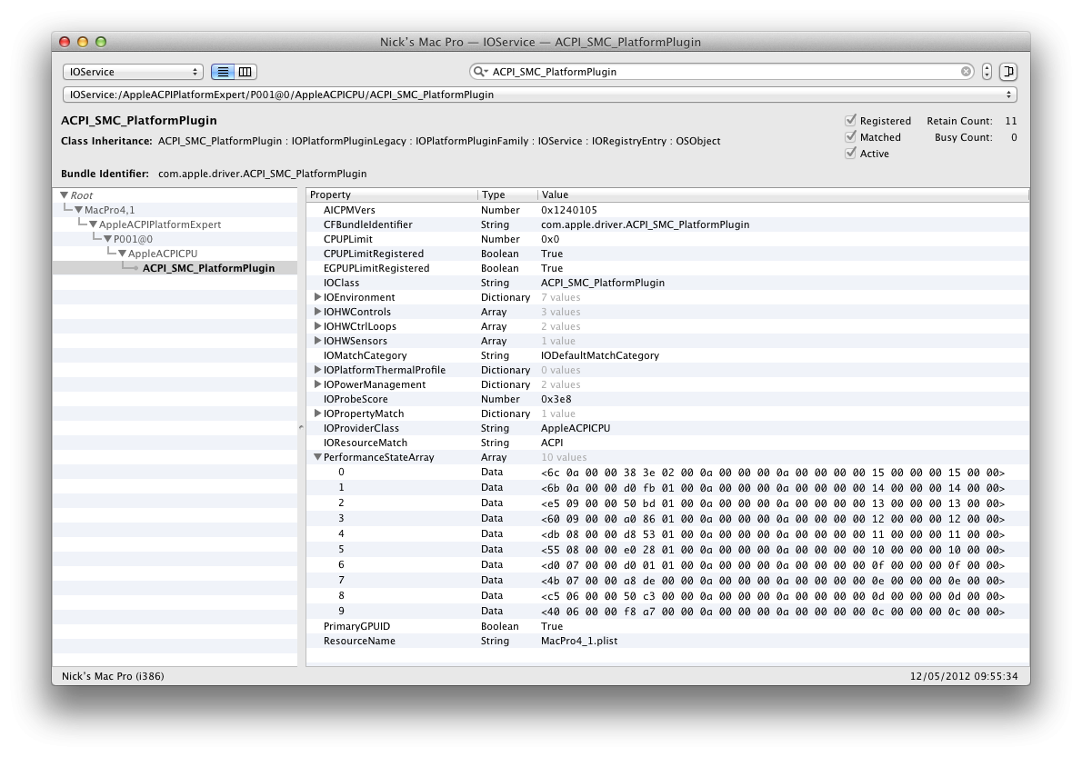

leomenassun Posted May 12, 2012 Share Posted May 12, 2012 blackosx said: ...maybe I can have a look sometime in the future. No problem. I'll wait. blackosx said: Well if you're positive the thermal paste has been applied (I know you said an engineer did it for you) then I can suggest only that you get a better aftermarket cooler and look at the airflow in and out of your case. Is the PC stuck in a corner somewhere, would moving it help? The airflow is ok. Anything is stuck. blackosx said: It only appears once Intel® C-STATE Tech is enabled. I see it here under:Advanced -> CPU Configuration If you want, I'll post a photo of my screen? I've disabled and enabled C-State Tech in order to check if C6 set would appear. But it hasn't. It might be a set not found in BIOS 1701. This is my guess. It's not necessary to post a photo of your screen. Thanks! =) blackosx said: No - remove those. Your board's native tables are good to use.One way to check for your p-states is to load up IORegistryExplorer (from Apple's developer tools) and check the PerformanceStateArrary under AppleACPICPU -> ACPI_SMC_PlatformPlugin. Here's a screenshot from my end: Without P and CStates flags, the cpu temps get stuck on 83ºC!!!! blackosx said: Well to be honest, not much. I won't have any spare time this weekend so I'm happy to leave you to play with your system and learn more about it. There's a wealth of information out there to read if you want to learn. For example - looking at your System-Profiler.spx file I can see: SMC Version (system): 1.30f3 when really, when trying to emulate a MacPro4,1 is should be more like: SMC Version (system): 1.39f5 I'll leave that one for you to play with - for a start read this post at Prasys's blog. Well done and keep up the good work Ok, I'm gonna work on it. Thank you very much, Nick! EDIT 2: I've got 1.39f5, but I was not able to set TjMax as Prasy has suggested! Cheers! Link to comment Share on other sites More sharing options...

blackosx Posted May 13, 2012 Share Posted May 13, 2012 leomenassun said: I've disabled and enabled C-State Tech in order to check if C6 set would appear. But it hasn't. It might be a set not found in BIOS 1701. This is my guess. It's not necessary to post a photo of your screen. Thanks! =)../snip/.. EDIT 1: Without P and CStates flags, the cpu temps get stuck on 83ºC!!!! What boot options do you have in org.chameleon.Boot.plist? Maybe we need to double check your BIOS settings. This is what I see: leomenassun said: EDIT 2: I've got 1.39f5, but I was not able to set TjMax as Prasy has suggested! Well done. The Tjmax setting is no longer in FakeSMC's info.plist but now in IntelCPUMonitor.kext's info.plist - one of FakeSMC's plugins. I think I'm right in saying it defaults to 100, but there is an existing entry to allow it to be changed. TjMax 0 However, a Tjmax of 100 is fine for the i7 920 2.67Ghz. Aida64 in Windows reports the following for my CPU: CPUID Manufacturer GenuineIntel CPUID CPU Name Intel(R) Core(TM) i7 CPU 920 @ 2.67GHz CPUID Revision 000106A5h IA Brand ID 00h (Unknown) Platform ID 2Fh / MC 02h (LGA1366) Microcode Update Revision 11 HTT / CMP Units 2 / 4 Tjmax Temperature 100 °C (212 °F) CPU Thermal Design Power 130 W CPU Thermal Design Current 110 A Max Turbo Boost Multipliers  1C: 22x, 2C: 21x, 3C: 21x, 4C: 21x leomenassun said: I don't have Apple's Developer Tools, do I? How can I get it? Is it free? Yep - The developer tools are free. You can download the latest version from Apple's app store. Load up Xcode, then from the Xcode menu, select Open Developer Tool -> More Developer Tools… where you will be able to download the Hardware IO Tools for Xcode. leomenassun said: Other questions: Is it necessary an antivirus solution? Which one do you suggest? / The Lion firewall is disabled by default. Should I enable it? We're going off topic here. But quickly, I'd say there's no need for any antivirus - just use your common sense if anything asks for your authentication. And yes, turn the firewall on. Link to comment Share on other sites More sharing options...
