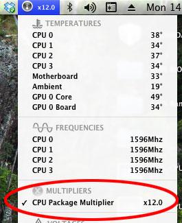

You can use FakeSMC's plugins to help show your temps and working speedstep. Grab yourself the FakeSMC_plugins_Apps_rev609.zip from projectosx. Add IntelCPUMonitor.kext and WinbondW836x.kext to your /Extra folder alongside your existing FakeSMC.kext and re-run myHack -> myfix -> quick to update your myhack.kext and caches etc. then reboot. Once booted back up, run the HWMonitor app and you will see a new item in the menubar. You will then be able to see your temps and current multiplier. Here's a pic from my system:
The multiplier changes here from 12 to 21 depending on what I'm doing.
Done. My pic is attached. I've noticed that my LCD Poster (do you still have yours?) shows me one temperature (62ºC) and HWMonitor shows me another (68ºC - higher!) - by the way with P and CStates set back into org.chameleon.boot.plist. (Sorry, but I had to change it again in order for the temperature not getting stuck on 83ºC).
Well done :)
And I can see your CPU Package Multiplier is at it's lowest p-state (x12) which is good.
