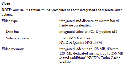

Administrators Hervé Posted October 29, 2013 Administrators Share Posted October 29, 2013 No, it's not possible. The Dell manual is pretty clear about that point: Link to comment Share on other sites More sharing options...

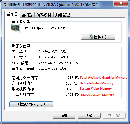

xworm Posted October 29, 2013 Author Share Posted October 29, 2013 No, it's not possible. The Dell manual is pretty clear about that point: Thanks , but I got the this under windows 7(64bit) Sorry for local language, I've tried to translate it into english: : Link to comment Share on other sites More sharing options...
Administrators Hervé Posted October 29, 2013 Administrators Share Posted October 29, 2013 Ok, I understand better now, I thought you were asking about increasing the on-board video memory which is not possible. Anyway, if performance is not great, it's unlikely to be due to unsufficient Video memory, but more to non-optimum platform profile settings. I recommend that you read the article about "Performance Tuning with FakeSMC" in the Articles pages of the web site and adjust your laptop's settings accordingly. I can tell you that I do not experience any particularly poor performance on my D630 nVidia 135M with FakeSMC v5.2.678, SMC id set at 1.33f8 and SMBIOS profile set as MacBook Pro5,1. We tested this profusely a few months ago and reached top optimal performance, including graphics performance. On 64bit Mavericks 10.9, you may actually use any recent release of Kozlek's FakeSMC kext + HWMonitor app. Be cautious as the downloaded package will install the FakeSMC kext (with plugins inside) in /S/L/E. You need to move that back to /E/E and re-run myFix (full) for the kext to be used subsequently after reboot. Link to comment Share on other sites More sharing options...
