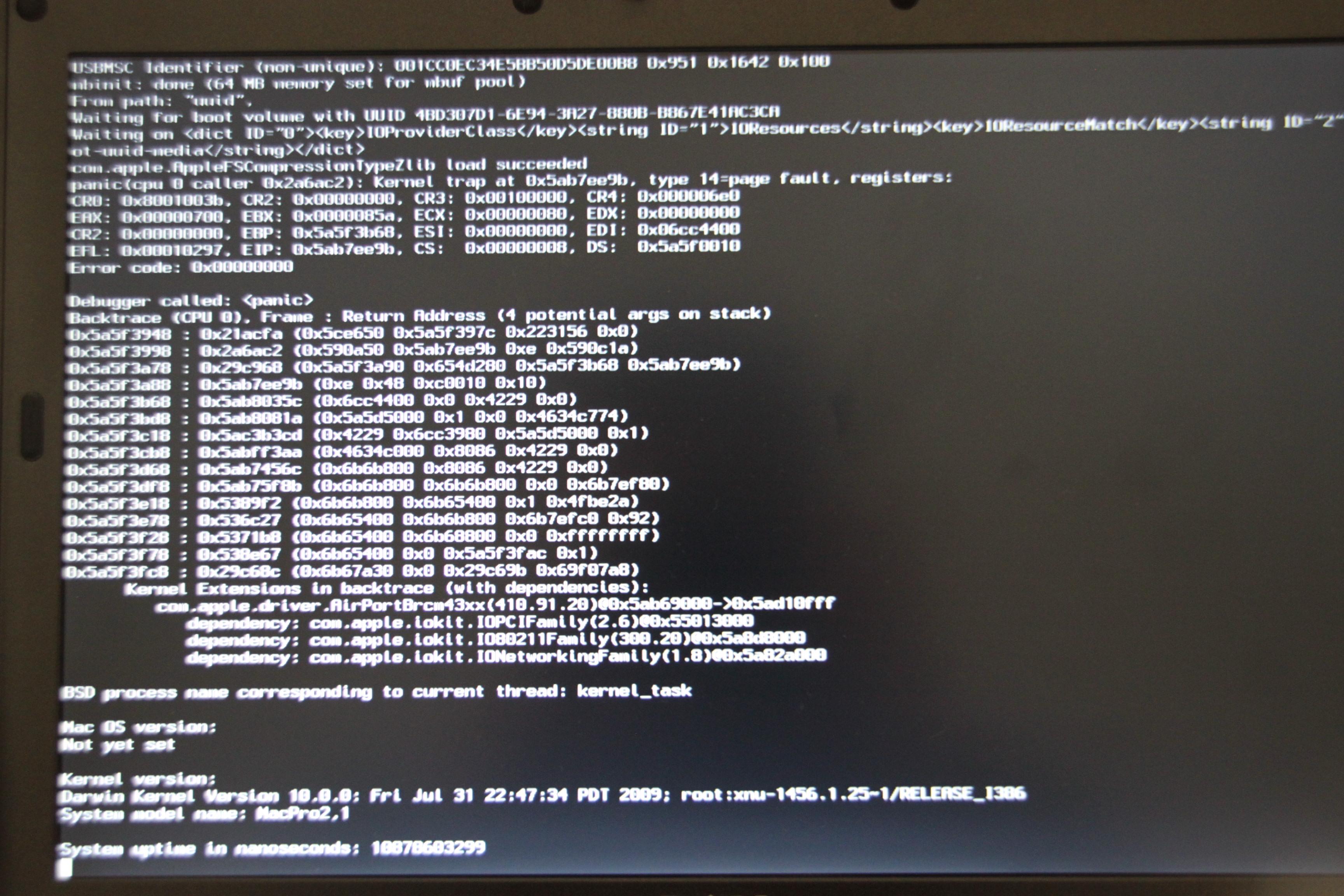

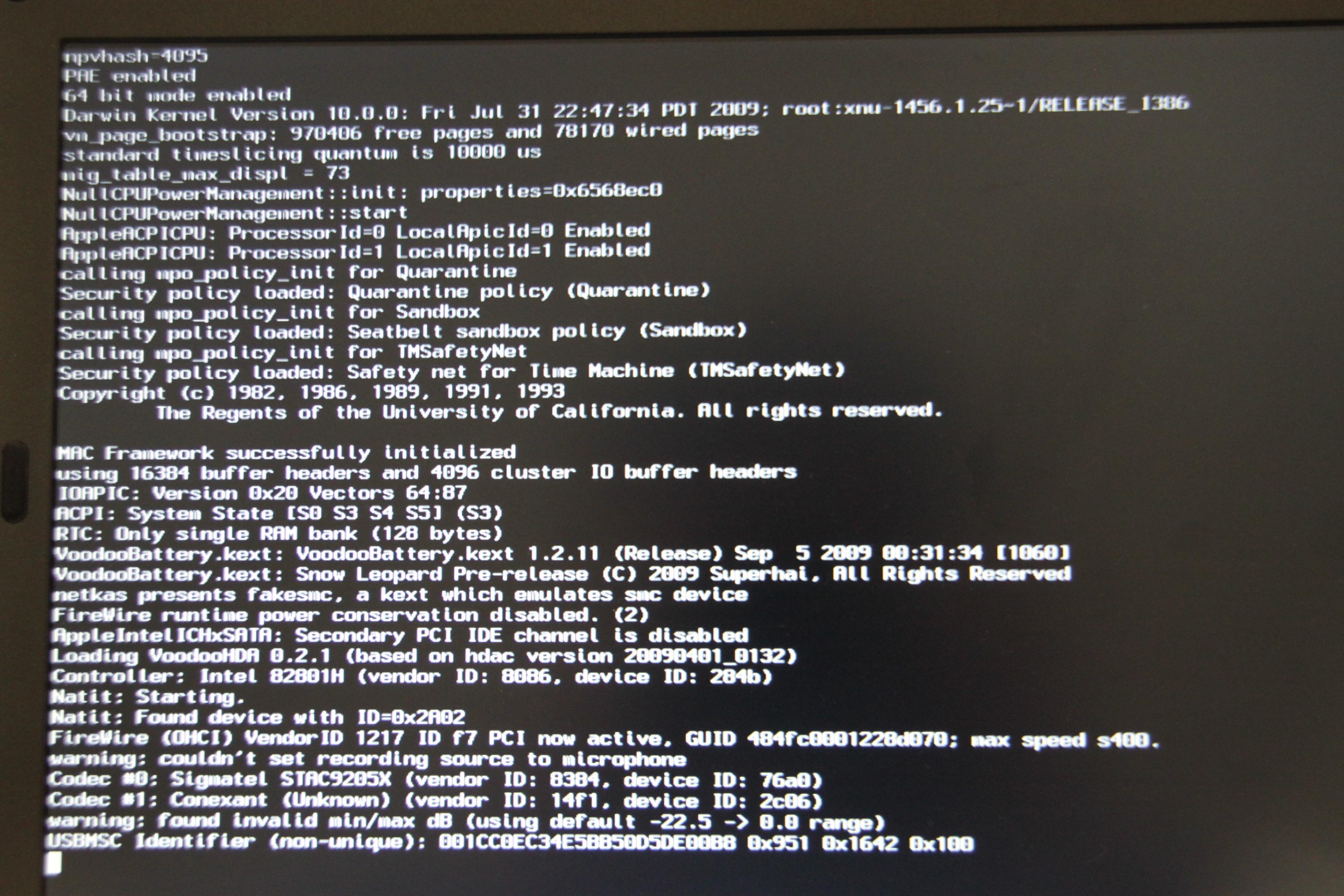

bernd Posted August 13, 2011 Share Posted August 13, 2011 Hello everybody! I am new to this Forum and hope that anyone here could help me installing Snow Leopard on my Dell D630. My Hardware: - Dell Latitude D630 - Intel Core 2 Duo CPU T9300 2.5 GHz - 4GB RAM - 14 Inch Display (1440x900) - Intel 965 Grafic What I have done yet: - Updated Bios to D630_OSX_INTEL.zip from WiKi - Because of having no MAC I created a USB-Pen with Method 2 from Wiki - Reseted Bios Defaults - Changed HDD Mode to AHCI in Bios Problem during installation: - When Booting from USB Stick (with option -v) I get an panic Error. I attached some pictures to explain the problem. I would be very happy if anyone here could help me! Link to comment Share on other sites More sharing options...
simeonoff Posted August 13, 2011 Share Posted August 13, 2011 Agh, you have an intel wifi card. Go in your Bios settings and turn off the wifi adapter. Unfortunately the bios you installed is for 1280x800 screens only I'd recommend you booting with -v -x and see if it boots. If it doesn't then we'll have to do something else. I'm more than willing to help! Cheers mate! Link to comment Share on other sites More sharing options...
Administrators Bronxteck Posted August 13, 2011 Administrators Share Posted August 13, 2011 you an also try npci=0x2000 -v at chameleon boot prompt Link to comment Share on other sites More sharing options...
