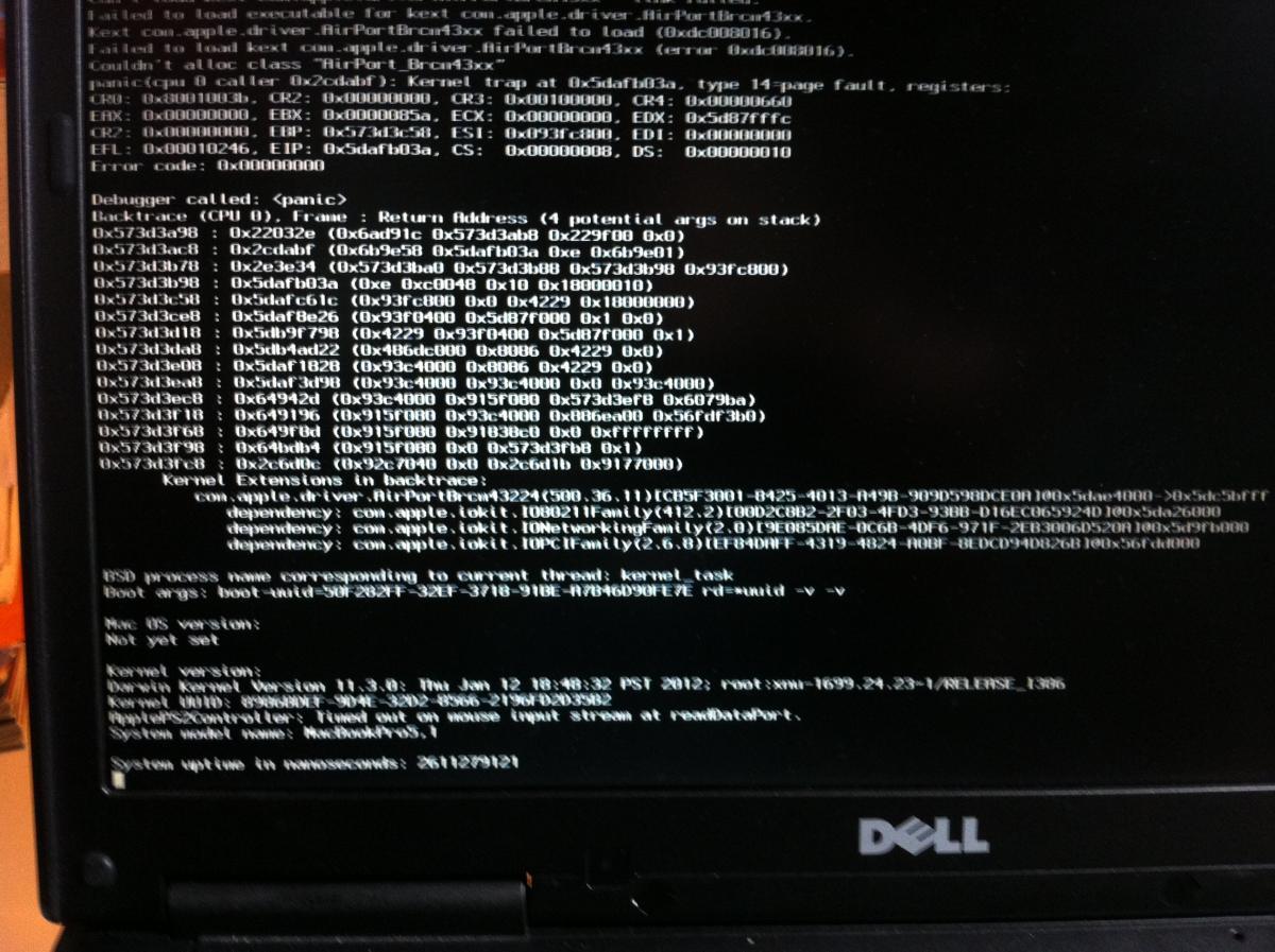

lian li Posted April 16, 2014 Share Posted April 16, 2014 hello, please help me getting started with snow leopard on my dell 830 intel graphic 4gb ram core duo 2,.0 laptop. see the picture problem is about broadcom card airport, 43224 kernel. thanks Link to comment Share on other sites More sharing options...
Administrators Bronxteck Posted April 16, 2014 Administrators Share Posted April 16, 2014 try shutting off wifi from bios. or remove the broadcom 43xx kext from Extra/Extensions then run a my fix quick. Link to comment Share on other sites More sharing options...
Administrators Hervé Posted April 16, 2014 Administrators Share Posted April 16, 2014 BCM43224 card is unsupported as indicated here. You'll need to swap it out for a supported model. Link to comment Share on other sites More sharing options...
