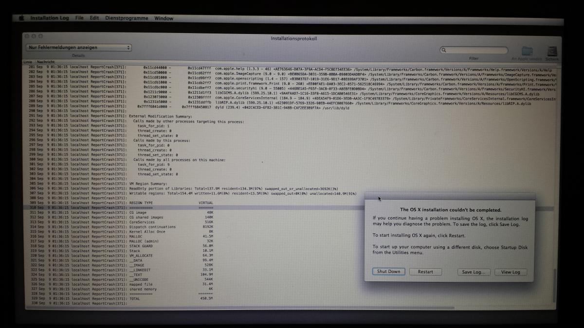

DerPeiler Posted September 9, 2014 Share Posted September 9, 2014 Hi all, as first, thanks for this board, very nice to have one like this! I'm using a Latitude E6530 and try to install Mavericks, the installation is not succesfull and abort after i choose the system language (german) with an error. Please check the attached screenshot. Here my System configuration. CPU: i5-3320Mn @ 2.60GHz Memory: 1x4gb Graphic: Intel + NVIDIA HDD: 500GB Wireless: DW1505 (used in wwan slot) / intel wifi card removed Before i started with the installation i upgraded BIOS to A12, load BIOS default, change Sata Operation to AHCI and disabled Optimus... Prepared my USB flash drive with the latest version of myHack 3.3.1, using Mavericks 10.9.4 from store and use the Extra_Mav.zip from Jake Lo's tutorial... https://osxlatitude.com/index.php?/topic/5660-dell-latitude-e6430e6530-with-nvs5200m-hd4000/ I tried already to use only a external mouse to perform the installation and choose also english as language, all the time the same failure. Hope someone can help me. Thanks! Link to comment Share on other sites More sharing options...
Administrators Hervé Posted September 9, 2014 Administrators Share Posted September 9, 2014 Did you partition your target HDD in GPT/GUID mode and format the target partition as Mac OS Extended (journaled) before starting the actual installation? Link to comment Share on other sites More sharing options...
DerPeiler Posted September 9, 2014 Author Share Posted September 9, 2014 no i don't think so..., the installation stops directly after i choose the language, so i'm not able to select a target disk or anything... can you advise me please how i should do this before? Thanks! edit1: i'm very frustrated now... i'm a absolutly beginer in hackintosh, done my first steps last week by installing a VM but want it now on a native system and reading a lot of tutorials but i din't have luck. I tried now to recreat my install usb stick, maybe i do somoething wrong before, by using the step by step documantation here on this site... http://www.osxlatitude.com/edp/documentation/pre-installation/ Erase the flash drive, run myhack 3.1.1 as documentated... install Extra (bootpack) for the Latitude E6530, load BIOS defaults again, disable optimus and switch to AHCI, Boot mode is set to legacy and secure boot is disabled. Now when i'm trying to boot from my flash drive i got a error message. " boot0:GPT boot0:GPT boot0:GPT boot0:GPT boot0:GPT boot0:error " thats all... Before i was able to launch the bootloader and the setup.... Tried also a other falsh drive but got the same error... As little Information...As i got the error from post one, i partition the local hard drive to Mac OS Extended (Journaled), maybe some mistakes here? Hopfully it's all clear what i want to say... Thanks! edit2: i boot now from a Windows 7 dvd and started the rescue options to get access to a command line and use the following commands list diskselect disk 0cleanconvert gpt same failure as in edit1 on boot from usb flash drive Link to comment Share on other sites More sharing options...
