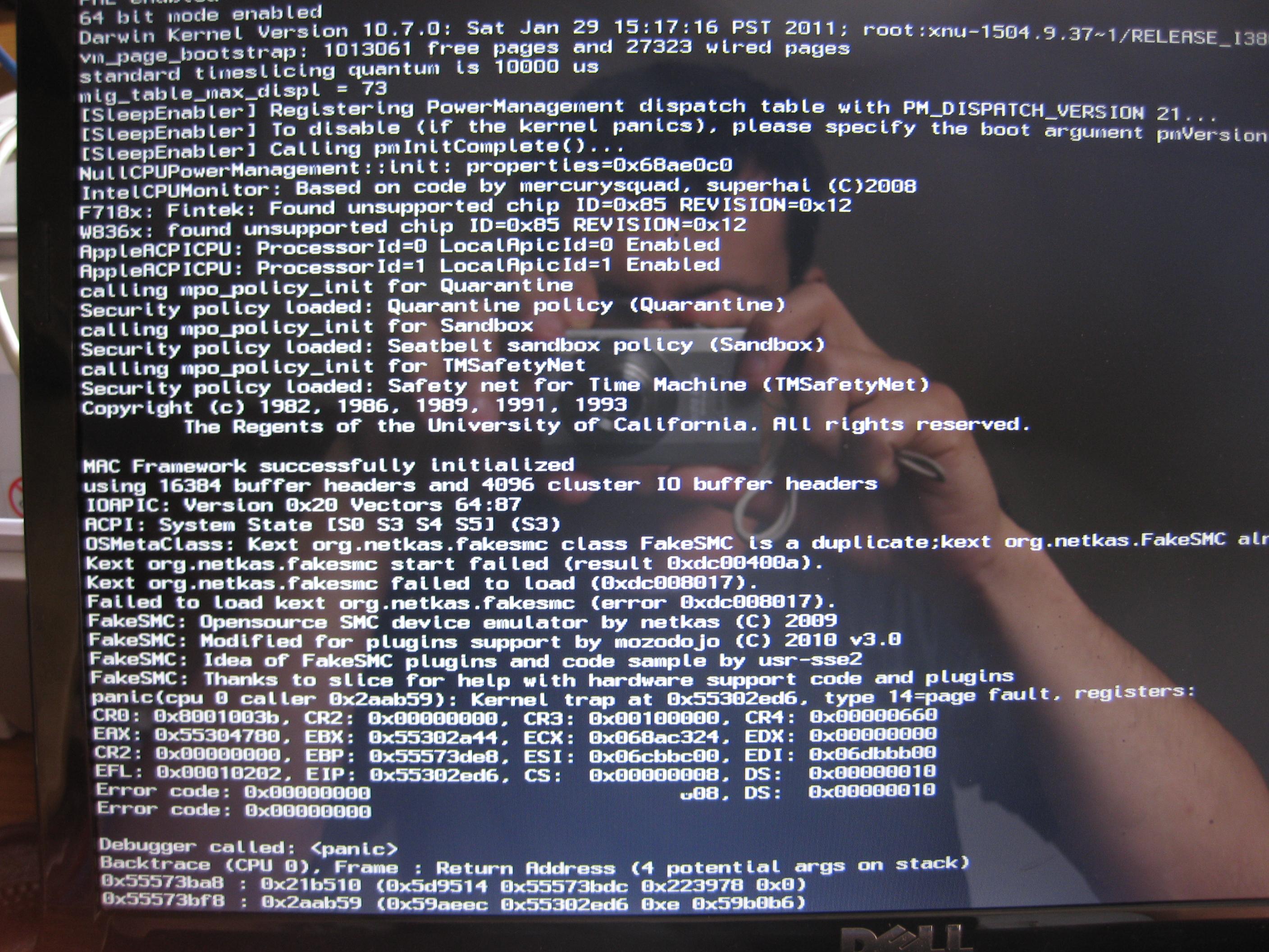

dhcp Posted October 10, 2011 Share Posted October 10, 2011 sorry for my last wrong section post... hi, i'm new here and i'm searching stuff for my dell laptop any chances to use EDP with my dell studio 1555? (core2duo p8600, ati radeon hd 5100, broadcom netlink gigabit, wireless 1390) now i use osx SL 10.6.6 quite working (graphic acceleration works) but at boot sometimes KP happen.. randomly best is obtain lcd brghtness control, sleep function and speedstep thank you in advance Link to comment Share on other sites More sharing options...

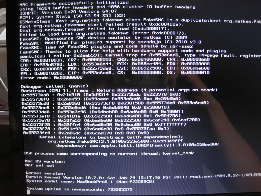

dhcp Posted October 13, 2011 Author Share Posted October 13, 2011 here some screens.. it happens randomly thank you my hardware: KP KP Link to comment Share on other sites More sharing options...
albert e Posted October 16, 2011 Share Posted October 16, 2011 here some screens.. it happens randomly thank you my hardware: KP KP Remove FakeSMC 3.1 kext in Extra/Extensions/ Link to comment Share on other sites More sharing options...
