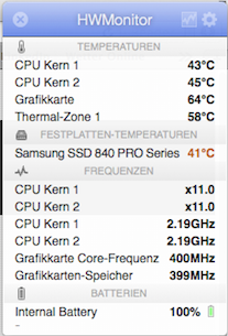

neverly1 Posted January 19, 2015 Share Posted January 19, 2015 Hi, I have a D830 with two installations First Mavericks with Chameleon bootloader Second Yosemite with Clover bootloader I recognize a difference with speedstep. With Mavericks and Chameleon CPU temperatures are at 40 degree and the multiplier are at 3 normally. See picture. With Yosemite and Clover the temperatures are at 70 degree and the multiplier are minimum at 6. Where is the difference? Where can I adjust speedster? Any idea is welcome. Thanks and best regards neverly1 Link to comment Share on other sites More sharing options...
Administrators Hervé Posted January 19, 2015 Administrators Share Posted January 19, 2015 You can't manually adjust SpeedStep, it's automatic and under the control of AICPUPM kext in conjunction with recent/latest Kozlek's FakeSMC kext + SMBIOS profile (once suitably tuned/configured), P + C States generation being activated in the bootloader. I would make sure that your Clover-based installation: . uses same FakeSMC kext (version + key tuning) as the Mavericks installation. Kozlek's latest versions can be used. . uses MacBookPro5,1 profile (set in Clover config). . uses P States + C States generation and nothing else (set in Clover config). Clover normally automatically selects MBP5,1 SMBIOS profile for those nVidia-based D630/D830 models, but if you notice that SpeedStep is not as efficient under Clover, resulting in higher T°, why don't you switch to Chameleon ? It totally supports Yosemite with recent versions such as v2.2 r2395 or r2401 for instance (I use r2401). Later Chameleon releases fully support Yosemite too but I have experienced issues booting Mavericks with v2.3 r2510 on a multi-OS X installation disk. Link to comment Share on other sites More sharing options...
neverly1 Posted January 20, 2015 Author Share Posted January 20, 2015 Thank you for your reply. I did a fresh installation with Yosemite and chameleon as a boot loader. Funny thing, temperatures are ok. Not as good as with the Mavericks installation. I use a newer FakeSMC version now, as HWMonitor did not work with the old version. But better than Yosemite and Clover. Confusing for me, what happened there. Link to comment Share on other sites More sharing options...
