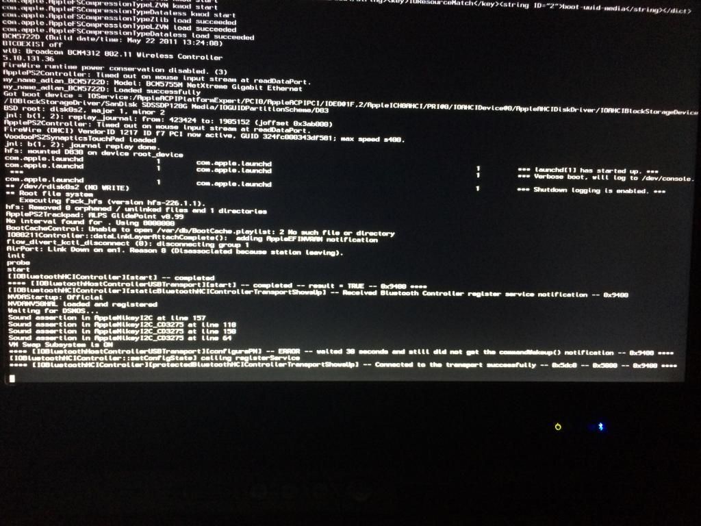

luke9511 Posted February 15, 2015 Author Share Posted February 15, 2015 ok i got the new kexts installed and ran myhack and so far stuff seems ok, still got that black screen on boot sometimes not sure what that is or how to find out and i also no longer have audio EDIT i have also attached my extra folder Extra_backup.zip Link to comment Share on other sites More sharing options...
Administrators Hervé Posted February 15, 2015 Administrators Share Posted February 15, 2015 Why do you use NullCPUPowerManagement? That defeats the purpose of having P&C States activated in your boot plist, the MBP5,1 profile and the tune FakeSMC... Get rid of it. In addition, on checking your DSDT, it turns out it has an incorrect configuration of the GPU section... Where did you get this DSDT? Here's a correct version: DSDT_D830_NVS-140M.aml.zip Link to comment Share on other sites More sharing options...
luke9511 Posted February 16, 2015 Author Share Posted February 16, 2015 Why do you use NullCPUPowerManagement? That defeats the purpose of having P&C States activated in your boot plist, the MBP5,1 profile and the tune FakeSMC... Get rid of it. In addition, on checking your DSDT, it turns out it has an incorrect configuration of the GPU section... Where did you get this DSDT? Here's a correct version: DSDT_D830_NVS-140M.aml.zip i did not edit the dsdt, all i did was use a virtual machine and a 10.9 dmg i downloaded and created a myhack install with the downloaded pack for the d830 EDIT how do i get rid of NullCPUPowerManagement? also everything is stock from a normal install, i did not even run EDP at all or tweaked anything EDIT 2 i forgot to add i was trying to fix the audio and now can no longer boot into normal mode only safe mode, i will just do i full erase and reinstall using the files posted here and see how far that gets me i think this is what is causing me to not boot into normal mode Link to comment Share on other sites More sharing options...
Administrators Hervé Posted February 16, 2015 Administrators Share Posted February 16, 2015 To get rid of NullCPUPowerManagement, simply remove it from /Extra/Extensions and run myFix (quick) as suggested and confirmed in posts #21 and #22. You can also try my edited DSDT by placing it in /Extra under the name of say DSDT_new.aml. You can then safely test it by calling on the file at bootloader prompt by typing: DSDT=/Extra/DSDT_new.aml. Once you're happy that it works, you can delete the old one and rename the new one into DSDT.aml. The DSDT will most defintely fix your black screen issue. I don't know what you were trying re: audio but it's a simple matter of using VoodooHDA + AppleHDADisabler kexts. You had them initially, there was nothing wrong there. If you can only boot into safe mode, you won't be able to run myHack/myFix app. However, you can manuall call myFix from Terminal using the command myfix -qt /. 1 Link to comment Share on other sites More sharing options...
