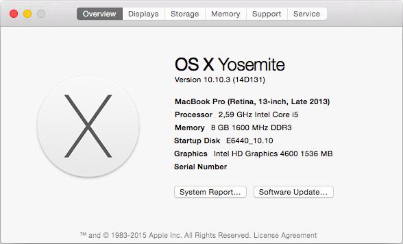

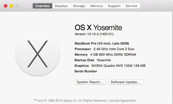

Administrators Hervé Posted April 8, 2015 Administrators Share Posted April 8, 2015 Straight update on Chameleon-based installations, no particular issue, at least on the D630 nVidia. As usual, SSD Trim has to be reactivated through IOAHCIBlockStorage kext binary patching (replacement of string "APPLE SSD" by a string of "00"). Of course, AGPM kext also needs repatching to regain throttle of the NVS 135M GPU, following details described in dedicated thread. IOAHCIBlockStorage.kext.zipFetching info... On the E6440 with Intel HD4600 graphics, things require a little more work due to the need to patch the Intel graphics-related kexts + OpenCL framework library. But it's the same as with previous Yosemite versions so no surprise there. On my Bronya's AMD kernel-based Precision 670, I had to replace the pthread kext by a rewritten version to avoid CPU-related KPs at boot time. Link to comment Share on other sites More sharing options...
