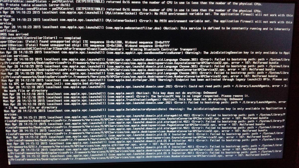

Artur96 Posted April 20, 2015 Share Posted April 20, 2015 When running the installer for 10.10.3, it stops at the following error messages:I have created the installer according to this guide using a Mavericks on VirtualBox.I have installed the required patched kernel along with all useful stuff in post #4.What do? Link to comment Share on other sites More sharing options...
Administrators Bronxteck Posted April 20, 2015 Administrators Share Posted April 20, 2015 hmm. remove the fakesmc plugins for now as there not needed for install one of them seems to be giving a warning. also what flags are you using? do yo have kext-dev-mode=1 ? Link to comment Share on other sites More sharing options...
Artur96 Posted April 20, 2015 Author Share Posted April 20, 2015 also what flags are you using? do yo have kext-dev-mode=1 ? I'm using -v -f plus some extra default flags (that includes kext-dev-mode). FakeSMC is located in S/L/E right? I'll remove it and report back tomorrow. Link to comment Share on other sites More sharing options...
Moderators Jake Lo Posted April 21, 2015 Moderators Share Posted April 21, 2015 Just tried the bootpack without an issue. Make sure you set your Bios to the default and only set the SATA Operation to AHCI. You might want to leave out the SSDT unless you have an i7-4600U. You can generate one for you CPU with ssdtPRGen.sh once you get the system up and running. Link to comment Share on other sites More sharing options...
Artur96 Posted April 21, 2015 Author Share Posted April 21, 2015 Now the installer gets stuck on Missing Bluetooth Transport Controller after removing SSDT and FakeSMC files. Link to comment Share on other sites More sharing options...
Moderators Jake Lo Posted April 21, 2015 Moderators Share Posted April 21, 2015 You need the FakeSMC kext included in the bootpack. Please list your system's specs or add it to your signature. It'll give us a better idea of how to assist you. Link to comment Share on other sites More sharing options...
Artur96 Posted April 21, 2015 Author Share Posted April 21, 2015 OK, I have reinstalled the FakeSMC kext, defaulted my BIOS and set SATA Operation to AHCI.I still get the same errors. Link to comment Share on other sites More sharing options...
Moderators Jake Lo Posted April 21, 2015 Moderators Share Posted April 21, 2015 Only difference with my E7240 is that I have an i5-4300U but I checked your processor, it does have an Intel HD 4400 and should be supported with my bootpack. You could try leaving out the DSDT as well and boot with DSDT=0 -v -f GraphicsEnabler=Yes IntelAzulFB=12 If that still doesn't work, there might some issue with your Installer. Make sure that if your Installer is from 10.10.3 and that the patched Haswell Kernel is also 10.10.3 in /System/Library/Kernels/kernel Link to comment Share on other sites More sharing options...
Artur96 Posted April 21, 2015 Author Share Posted April 21, 2015 Still getting the same errors. I'll check my installer then and report back soon. EDIT: I've checked the build version and it's 14D136. The correct kernel is also in the directory you've mentioned. I've made an installer using Yosemite 10.10.1 last week, which managed to install but later on couldn't boot. Since Yosemite isn't very stable in VirtualBox, I've decided to attempt to make another (this) installer in more-stable Mavericks. Do you reckon there's a difference between making an installer in Mavericks and Yosemite? Link to comment Share on other sites More sharing options...
Moderators Jake Lo Posted April 21, 2015 Moderators Share Posted April 21, 2015 I have no issue building from either version of OS X. Could possibly be a VirtualBox issue, it's been known to cause bad Installer. Link to comment Share on other sites More sharing options...
