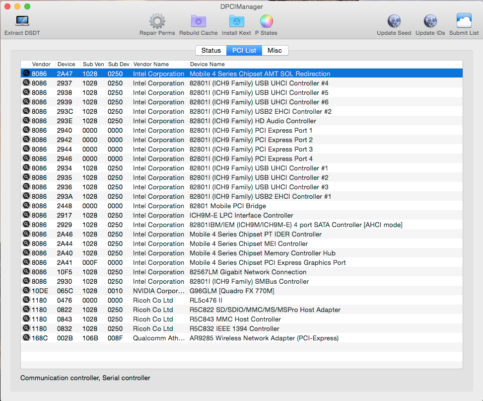

Moderators Jake Lo Posted May 6, 2015 Moderators Share Posted May 6, 2015 You got a lot of stuff in the kexts folder but might not be needed. Please list your devices User DPCIManager.app. Get a screenshot of the PCI list. Link to comment Share on other sites More sharing options...
marshall Posted May 6, 2015 Author Share Posted May 6, 2015 owh...I just copied all kext from my prev mavericks here is screenshot of PCI List : [/url]">http://http://s1134.photobucket.com/user/marshallfreakz/media/Screen%20Shot%202015-05-07%20at%206.44.30%20AM_zpszw17cl4g.png.html'> Link to comment Share on other sites More sharing options...
Moderators Jake Lo Posted May 7, 2015 Moderators Share Posted May 7, 2015 Try installing attach AppleHDA to /S/L/E, make a backup of the original if you like. For sleep, try enabling Asus AICPUPM in your config.plist. Remove BCM5722D, NullCPUPowerManagement, HDAEnabler, SleepEnabler and Patched_10.7_AppleRTC from Kexts/10.10 AppleHDA.kext.zip Link to comment Share on other sites More sharing options...
