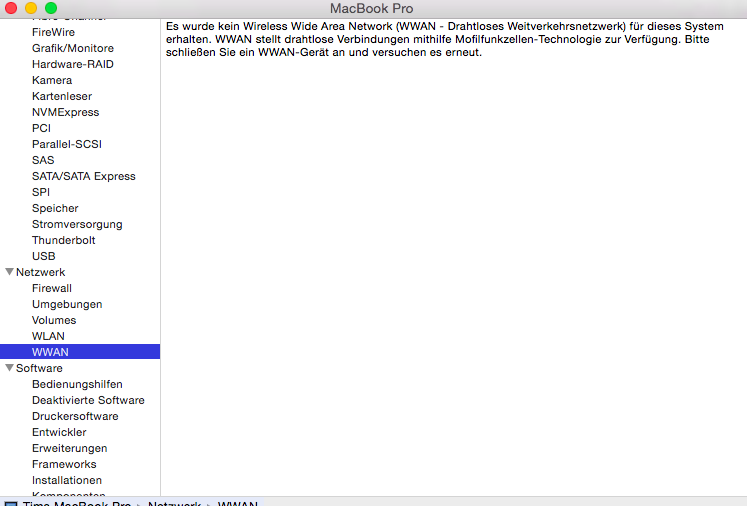

aaalias Posted September 16, 2015 Share Posted September 16, 2015 Hello, i already found 2 instructions but i can´t get it to run. I have a new symbol in the taskbar but it´s not shown in the system information Link to comment Share on other sites More sharing options...

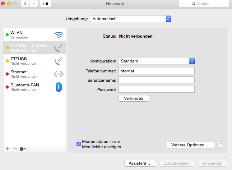

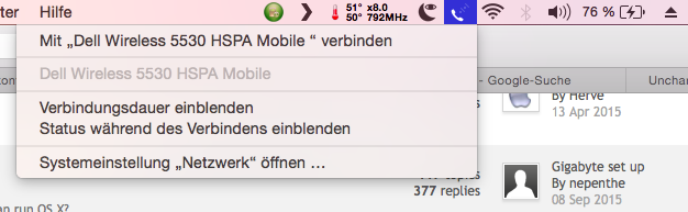

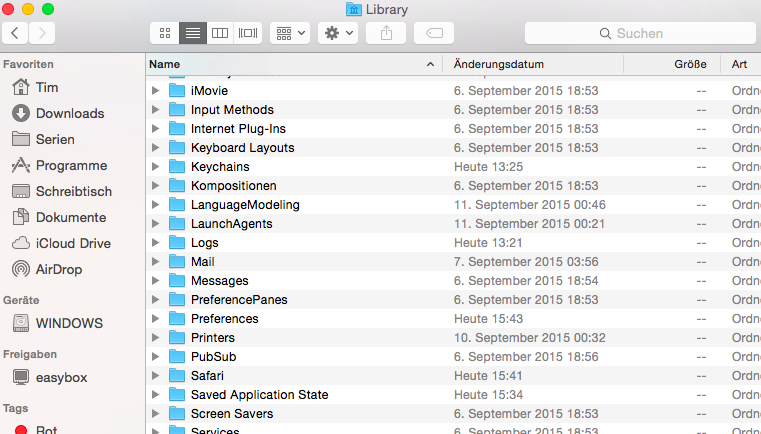

aaalias Posted September 16, 2015 Author Share Posted September 16, 2015 It´s 10.10.5 I tried this instruction: https://osxlatitude.com/index.php?/topic/2950-wwan-ericsson-f3507g-dell-wireless-5530/ I could´t find the "Modem Script" Folder (Picture1), so I created one. I think there should be "Modem Script" because of Picture 2. Is it invisible? Probably I can´t just create such folder? Picture 3 means no WWAN Link to comment Share on other sites More sharing options...

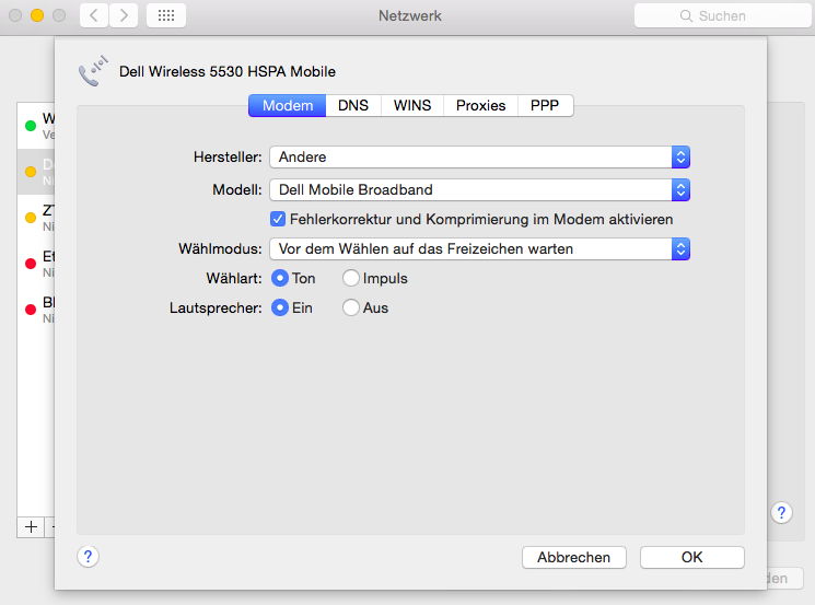

aaalias Posted September 18, 2015 Author Share Posted September 18, 2015 Working now: 1. Download this script: mobile-broadband.zip 2. Open: HD/Library/Modem Scripts (i looked at User/Library before) 3. Copy "Dell Mobile Broadband" to Modem Scripts As you can see at picture 1 I wrote "internet" for Phone Number, its my contractors APN After that go to Options and choose Manufacturer: "Other" You are able to finde "Dell Broadband" in the Modell List. No Password or anything else needed Link to comment Share on other sites More sharing options...
