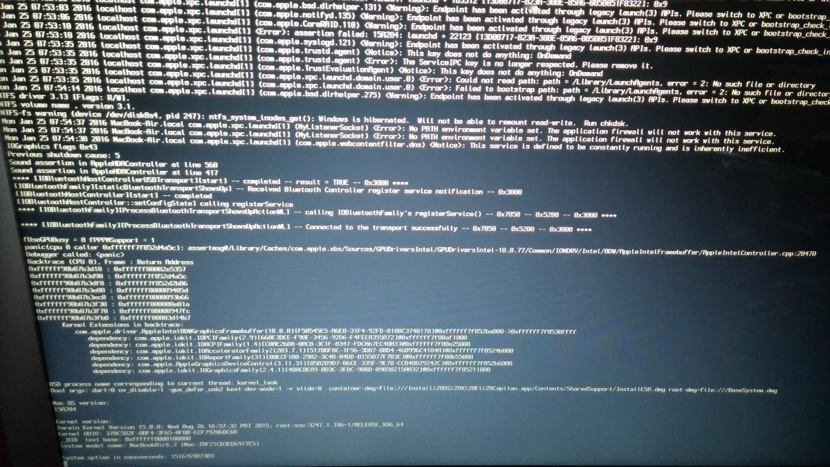

mixmaster57 Posted January 25, 2016 Share Posted January 25, 2016 Hello everybody!Help!! Lol i'm getting mad, i downloaded the bootpack from this website and i cannot reach El capitan installer.I always have a kernel panic...check my screen capture please. I aslo attached my EFI folder.I didn't modify the config plist I'm a newbie so anyone can help me? My specs : Lenovo Z51-70, i5 5200U, Intel HD 5500 + AMD Radeon R7 M360, FHD screen EFI_folder.zipFetching info... Link to comment Share on other sites More sharing options...

Moderators Jake Lo Posted January 26, 2016 Moderators Share Posted January 26, 2016 The problem is your graphics is not loading requiring your BIOS DVMT set to 96MB. Make sure to set Bios Using Graphics UMA only Link to comment Share on other sites More sharing options...

Moderators Jake Lo Posted January 26, 2016 Moderators Share Posted January 26, 2016 Perhaps manually patching the graphics kext rather than using the patch-on-the-fly which requires cache to work. Link to comment Share on other sites More sharing options...
ypdeveloper Posted January 27, 2016 Share Posted January 27, 2016 replace this kext in your usb installer location-System/extentions AppleIntelBDWGraphicsFramebuffer.kext.rarFetching info... Link to comment Share on other sites More sharing options...
