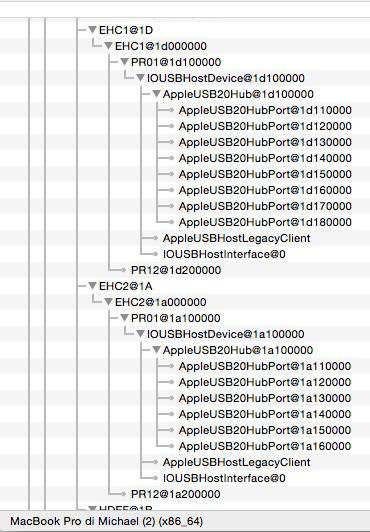

Administrators Hervé Posted January 31, 2016 Administrators Share Posted January 31, 2016 Duly noted about BT being enabled in BIOS. By their own very nature, you don't (can't) inject USB devices in/through DSDT. And don't confuse external USB2.0/USB3.0 ports and internal USB (sometimes 1.x) ports. I'm not sure those are working Ok for you... Can you extract an IOReg with IORegistryExplorer and post it? Link to comment Share on other sites More sharing options...
GigaSonic Posted January 31, 2016 Author Share Posted January 31, 2016 here MacBook Pro di Michael (2).zip Link to comment Share on other sites More sharing options...

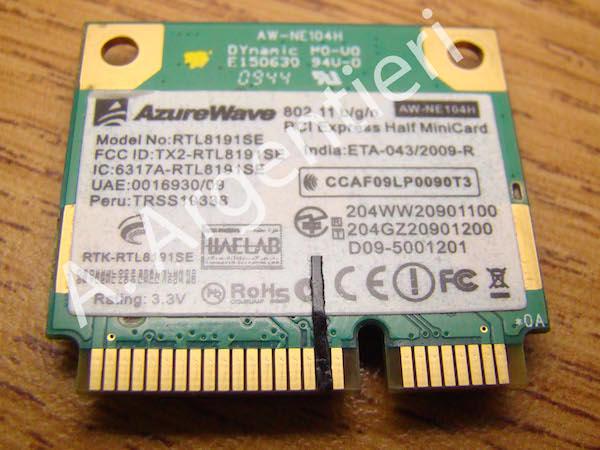

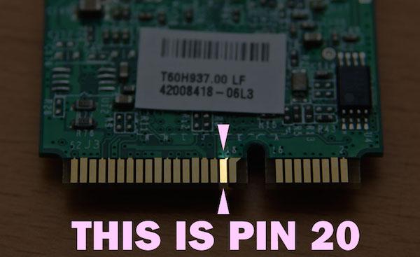

Administrators Hervé Posted January 31, 2016 Administrators Share Posted January 31, 2016 There's no sign of a Bluetooth device on your USB bus... Are you sure you have the AzureWave model with Bluetooth? There is a 943225HM (no BT) and a 943225HMB (with BT). If you're certain to have the HMB model and BT works in Windows, I'd strongly recommend you tape Pin20 as suggested by Bronxtech. Windows might be disabling BT on shutdown (taping Pin20 would keep the card fully activated). You could also try those 2 kexts in /S/L/E. They're Rehabman's work. They're also for ElCapitan, not for earlier versions but Rehabman's repo stipulates that the AzureWave BCM943225 does not normally require special FW for Bluetooth to be operational under OS X; 'should work OOB... BrcmFirmwareRepo.kext.zip BrcmPatchRAM2.kext.zip 1 Link to comment Share on other sites More sharing options...

Administrators Hervé Posted February 1, 2016 Administrators Share Posted February 1, 2016 Then you know what's left to try... Link to comment Share on other sites More sharing options...
GigaSonic Posted February 1, 2016 Author Share Posted February 1, 2016 tappping the pin? i try.. Link to comment Share on other sites More sharing options...
