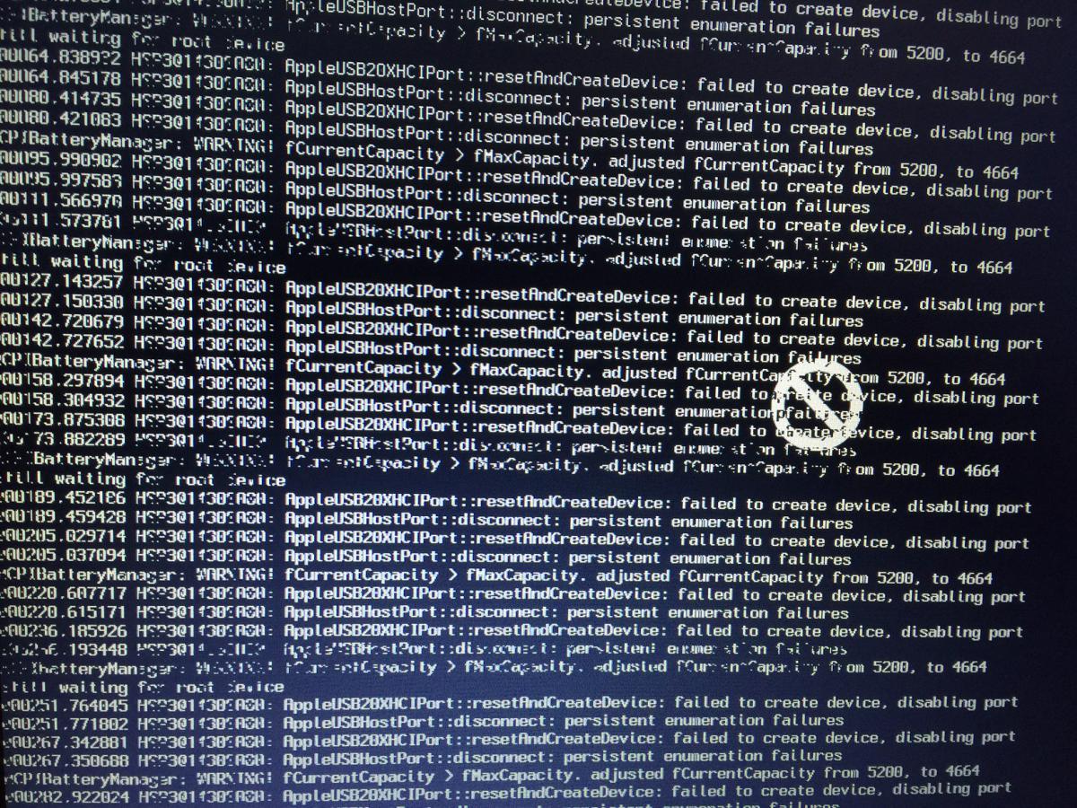

shahindoh Posted August 7, 2016 Author Share Posted August 7, 2016 Hi, I just finished going through the guide from Jake Lo.I followed it strictly and I got this after reboot. (screenshot attached)From reading other topics I understand this is issue with USB drivers.Issue is I'm not sure to understand how to solve this.Any clue ?Thanks. Link to comment Share on other sites More sharing options...

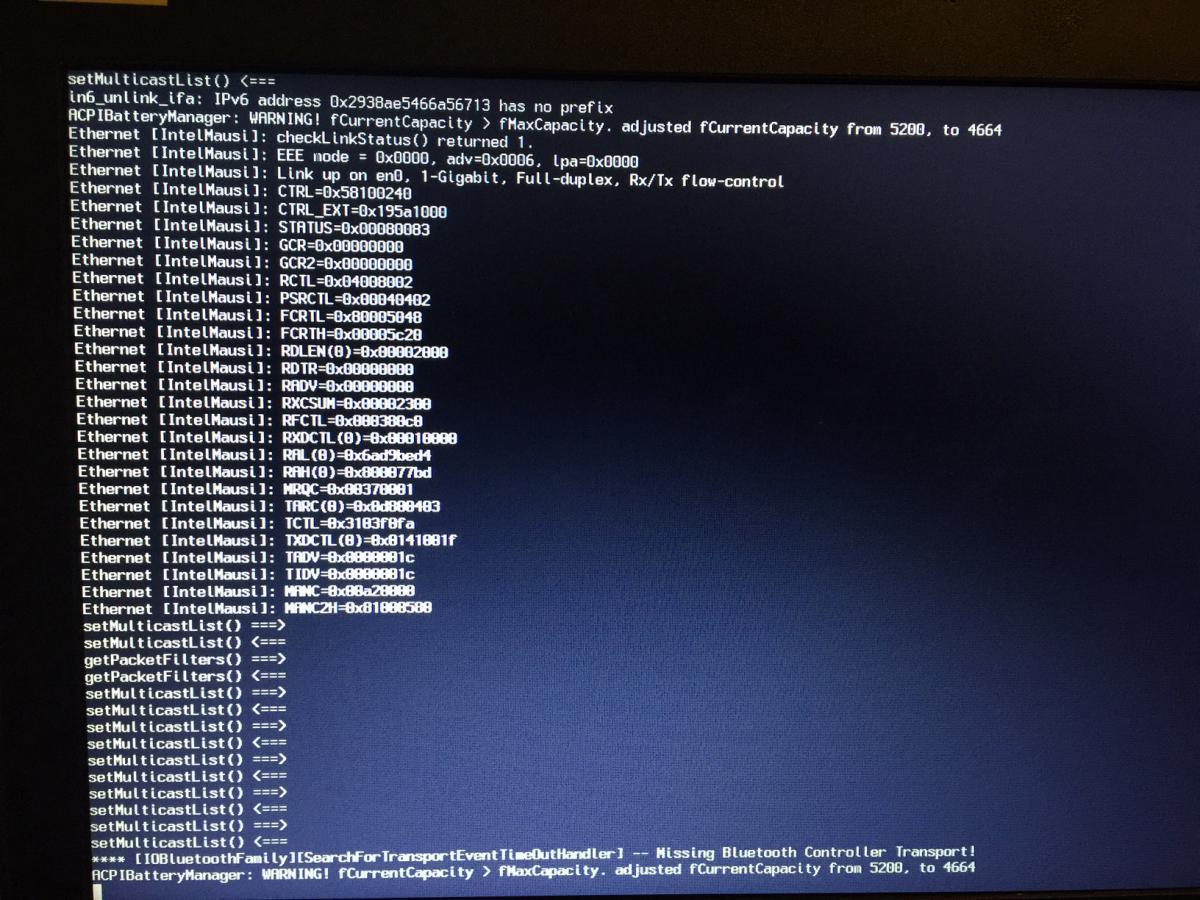

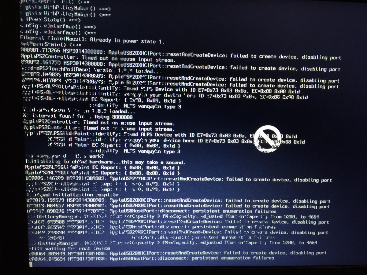

shahindoh Posted August 8, 2016 Author Share Posted August 8, 2016 Sorry about the previous post, I realized it may be linked to the fact I had parallel port disabled in BIOS so I enabled it again on PS2 and the error changed. It's now stuck after Missing bluetooth Controller Transport. Link to comment Share on other sites More sharing options...

shahindoh Posted August 8, 2016 Author Share Posted August 8, 2016 Reset your BIOS to factory settings, then set AHCI on and disable Optimus. Done I'm back to the AppleUSB20HXCIport error. (See attached) If this relates to USB issue that may have a big impact as I'm booting my system from External USB SSD bay... Link to comment Share on other sites More sharing options...
shahindoh Posted August 8, 2016 Author Share Posted August 8, 2016 I decided to test changing USB port, and the error gone and I'm back to "missing bluetooth controller transport"... This is driving me crazy Link to comment Share on other sites More sharing options...

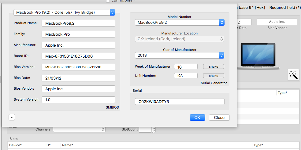

shahindoh Posted August 8, 2016 Author Share Posted August 8, 2016 What I don't understand is why I can run the system by booting from the USB stick Clover (the one used for install) and not from MAc SSD drive Clover. While I copied the EFI folder from stick to Mac drive as per the instructions in the guide. It looks to me that it's always when I set SMBIOS with Clover Configurator that it's starting to fail... Link to comment Share on other sites More sharing options...
shahindoh Posted August 8, 2016 Author Share Posted August 8, 2016 Guys, I wish I had not waited that much time without asking for help because you just made my day.Your combined help and this amazing guide + E6530_NVS package just solved everything on my machine.Video + sound all working perfectly. Thanks a lot.I did numbered screenshots during the whole process, are you interested in having those in a zip or pdf for some other users that may be wondering about some of the steps ? Happy new Hackintosh user. 1 Link to comment Share on other sites More sharing options...
