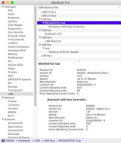

Administrators Hervé Posted December 9, 2016 Administrators Share Posted December 9, 2016 Erm... your SysProfiler output is from Mavericks... Not really what I was looking for. There is no sign of your DW1550 built-in BT module in your SysProfiler so it's clearly not registering as a USB device. I also note that you don't appear to use the latest optimised Mavericks' pack available here. Can you please post the saved SysProfiler output taken from El Capitan or Sierra with the DW1550 installed and the CSR dongle taken off? Whilst you're at it, also post: 1) your complete zipped /Extra folder (you're using Enoch, right?) without the Themes subfolder to minimise size 2) a saved IOReg output from IORegistryExplorer (both from El Capitan or Sierra) If you have an internal Bluetooth module such as a DW350 or DW360, disable the Internal Bluetooth in BIOS; otherwise, it'll take precedence... Your USB ports & devices should look like this under Sierra: As a test, I installed a spare Apple BCM94360CD (Combo Wifi 802.11ac + BT 4.0 card) in the WWAN slot of my D630. As expected, the Bluetooth module of the card is properly detected and listed as an internal USB device: Link to comment Share on other sites More sharing options...
