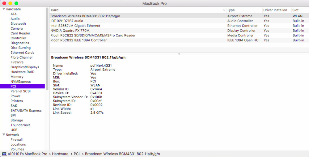

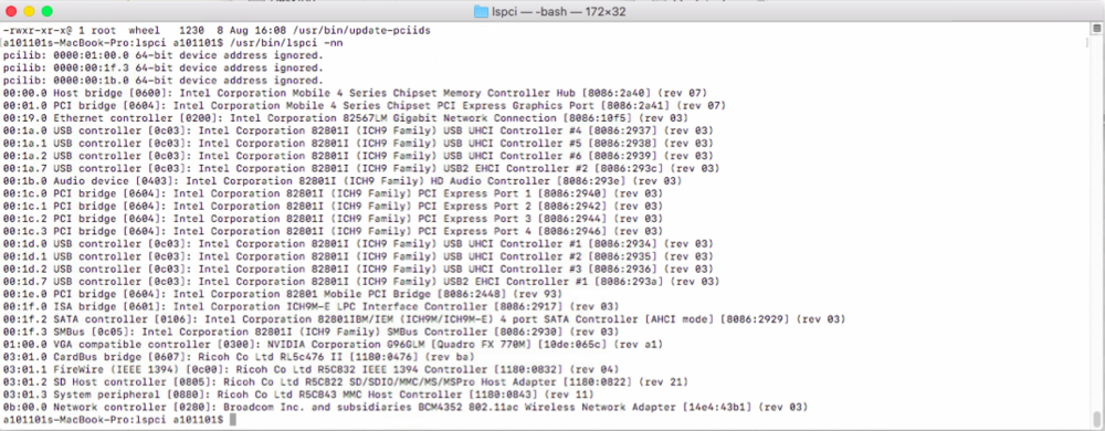

Working:
  • full CPU SpeedStep (with Generates P States + C States)
  • full graphics acceleration with nVidia Quadro FX770M OOB
  • full GPU throttling (with FakeSMC + AGPM tuning)
  • IDT 92HD71B7 audio (with VoodooHDA or patched AppleHDA)
  • Intel 82567LM Gigabit Ethernet (with Intel82566M)
  • Ricoh R5C822/R5C843 SD card reader (with patched VoodooSDHC)
  • Ricoh RC5832 IEEE 1394 controller OOB
  • Battery monitoring (with Rehabman's ACPIBatteryManager)
  • USB ports (with DSDT devices renaming + USB injector when necessary)
  • Sleep & wake (with hibernation disabled)
  • Wireless (with any compatible card)
