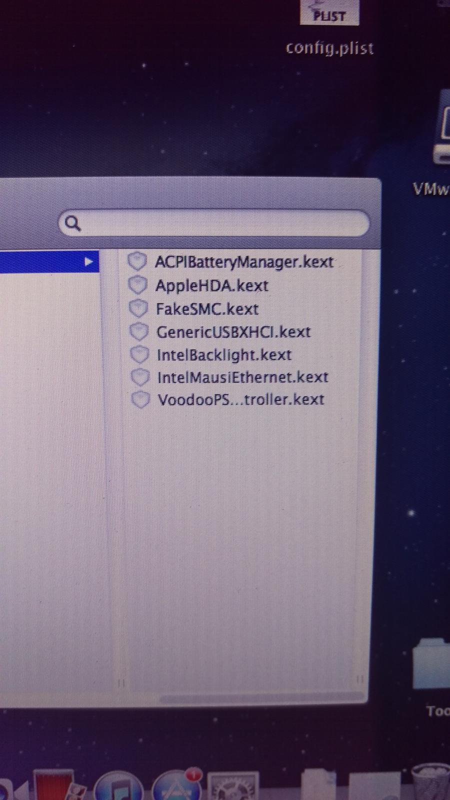

Morningstar Posted May 22, 2017 Author Share Posted May 22, 2017 hi Crew, i has istall mac surcessfull but any usb 3.0 port not working. how to fix this problem, and i can use kext 3.0usb suport mac sierra ? Link to comment Share on other sites More sharing options...
Morningstar Posted May 22, 2017 Author Share Posted May 22, 2017 and my tochpad not working,,,keyboard it ok , i don't know happened ? i had use RehabMan-Voodoo-2016-1208.zip 178.9 KB RehabMan 40980 2016-12-08 this herehttps://bitbucket.org/RehabMan/os-x-voodoo-ps2-controller/downloads/ Link to comment Share on other sites More sharing options...
Moderators Jake Lo Posted May 22, 2017 Moderators Share Posted May 22, 2017 That's because Rehabman's kext is for Synaptics Touchpad and yours has Alps. Use this instead 2 Link to comment Share on other sites More sharing options...

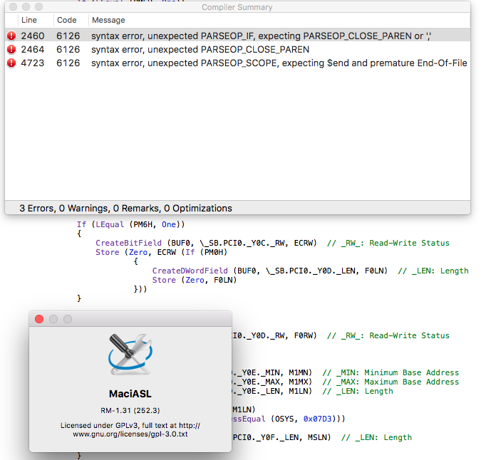

Morningstar Posted May 23, 2017 Author Share Posted May 23, 2017 Hi Friends, i try install again ,but i can't fix dsdt , can u help fix ?or give me how fixthis it my error dsdt 2460, 6126, syntax error, unexpected PARSEOP_IF, expecting ',' or ')'2464, 6126, syntax error, unexpected ')'2470, 6126, syntax error, unexpected PARSEOP_STORE2476, 6126, syntax error, unexpected PARSEOP_SHIFTLEFT2481, 6126, syntax error, unexpected PARSEOP_STORE2500, 6126, syntax error, unexpected PARSEOP_ELSE, expecting $end and premature End-Of-File Link to comment Share on other sites More sharing options...

Moderators Jake Lo Posted May 23, 2017 Moderators Share Posted May 23, 2017 Just a compiler error. Change this If (LEqual (PM6H, One)) { CreateBitField (BUF0, \_SB.PCI0._Y0C._RW, ECRW) // _RW_: Read-Write Status Store (Zero, ECRW (If (PM0H) { CreateDWordField (BUF0, \_SB.PCI0._Y0D._LEN, F0LN) // _LEN: Length Store (Zero, F0LN) })) } to this, should fix it and only error left is pnp0c14 which is easily fix. Rename "*pnp0c14" to "PNP0C14" If (LEqual (PM6H, One)) { CreateBitField (BUF0, \_SB.PCI0._Y0C._RW, ECRW) // _RW_: Read-Write Status Store (Zero, ECRW) } If (PM0H) { CreateDWordField (BUF0, \_SB.PCI0._Y0D._LEN, F0LN) // _LEN: Length Store (Zero, F0LN) } 2 Link to comment Share on other sites More sharing options...
Morningstar Posted May 23, 2017 Author Share Posted May 23, 2017 HI FRIENDS, i has fix my dsdt ,and i had one error12518, 6126, syntax error, unexpected PARSEOP_IFhow to fix ? please help me.. Link to comment Share on other sites More sharing options...
Moderators Jake Lo Posted May 24, 2017 Moderators Share Posted May 24, 2017 No error found, use this version, latest of MacIASL. Link to comment Share on other sites More sharing options...
Morningstar Posted May 24, 2017 Author Share Posted May 24, 2017 No error found, use this version, latest of MacIASL. i had dowload new version in here this version ,but i check in my file .dsl it is error 12661, 6126, syntax error, unexpected $end and premature End-Of-File how to this it ? Link to comment Share on other sites More sharing options...
