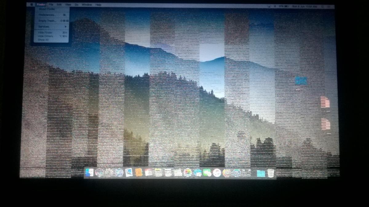

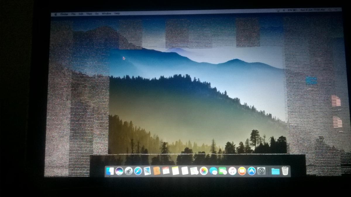

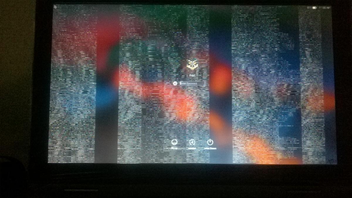

Amster Posted June 4, 2017 Share Posted June 4, 2017 I installed OSX Sierra in Dual-Boot in my Dell-Latitude e6430 Laptop all is working fine but their is problem in their display and USB not working. I have attached image and video regarding issue. Link to comment Share on other sites More sharing options...

Amster Posted June 5, 2017 Author Share Posted June 5, 2017 Please find attached image Link to comment Share on other sites More sharing options...
Moderators Jake Lo Posted June 5, 2017 Moderators Share Posted June 5, 2017 that's a well known discussed topic many many times here. downgrade your BIOS to A03, then upgrade it to A12 and not higher. Link to comment Share on other sites More sharing options...
Amster Posted June 6, 2017 Author Share Posted June 6, 2017 Hi, Now I am Downgrade BIOS to A12 and again install MAC.The USB device working fine but same display problem occurs.Please let me any suggestion to fix display problem. Link to comment Share on other sites More sharing options...

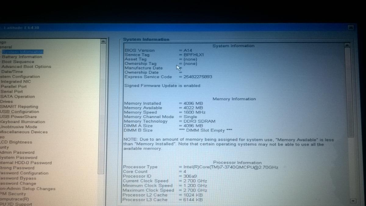

Administrators Hervé Posted June 6, 2017 Administrators Share Posted June 6, 2017 Did you downgrade to A12 as per the 2 x steps reminded by JakeLo? If you did, check the settings of DualLink parameter: 1) set to 0 if LCD resolution of lower than 1600x900 2) set to 1 if LCD resolution is higher than 1440x900 The LCD resolution also impact the Capri framebufer layout-id to use: 1) low res -> layout-id 0x01660003 2) high res -> layout-id 0x016660004 NB: your LCD native resolution is shown at bottom of System Information BIOS page. Link to comment Share on other sites More sharing options...
Amster Posted June 6, 2017 Author Share Posted June 6, 2017 Hi, Please let me know, I am downgrade BIOS to direct A12 from A14 is this right??or I have to downgrade BIOS to A03 then upgrade again to A12 Link to comment Share on other sites More sharing options...
