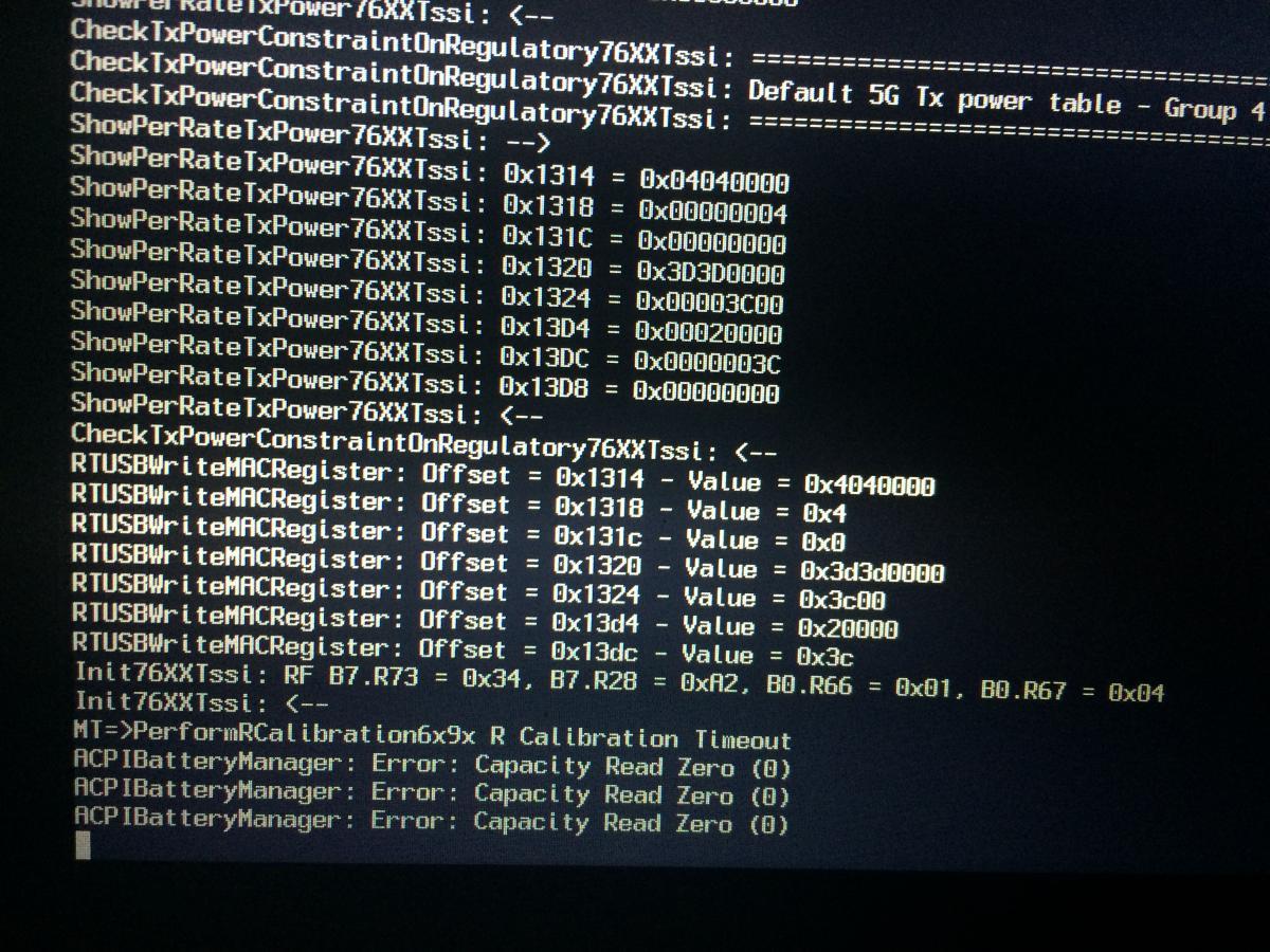

fwz.mhmd Posted July 17, 2017 Author Share Posted July 17, 2017 Well this bootpack was given to me by jake to try. My old one was backed up to my desktop computer, which was stupid of me. Which bootpack should i be using? Link to comment Share on other sites More sharing options...
fwz.mhmd Posted July 17, 2017 Author Share Posted July 17, 2017 1. I don't think I want to touch any files since I have messed up before. So my question is how do I re-instate. 2. How do I generate ssdt? Link to comment Share on other sites More sharing options...
fwz.mhmd Posted July 17, 2017 Author Share Posted July 17, 2017 I still can't boot after updating clover. Link to comment Share on other sites More sharing options...

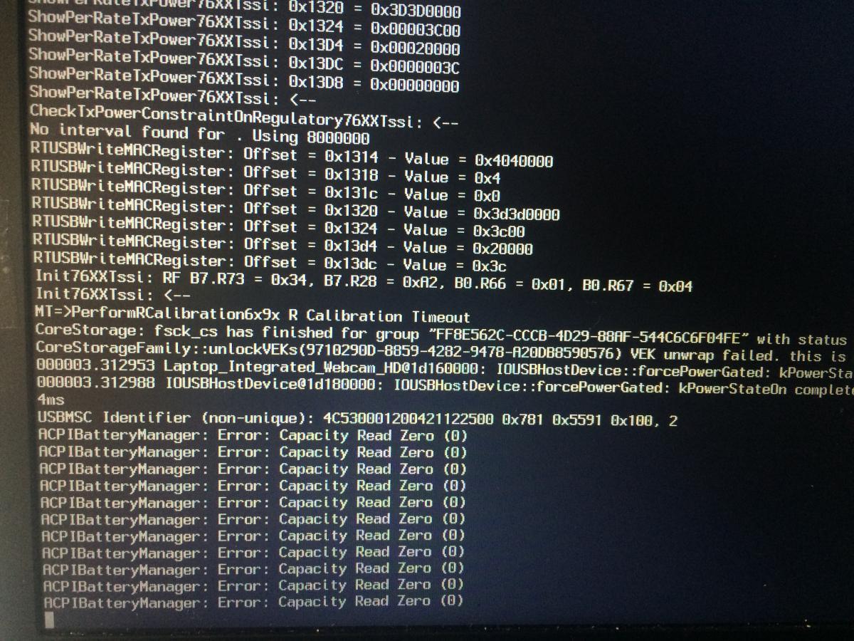

fwz.mhmd Posted July 17, 2017 Author Share Posted July 17, 2017 Nothing.Same error as above Link to comment Share on other sites More sharing options...
Moderators Jake Lo Posted July 17, 2017 Moderators Share Posted July 17, 2017 I wonder if it's the USB wireless kext you had installed but no longer supported when your system got upgraded See if you could boot to single user mode and remove the kext, or mount the drive on an USB adapter to another OS X system and remove the kexts. Link to comment Share on other sites More sharing options...

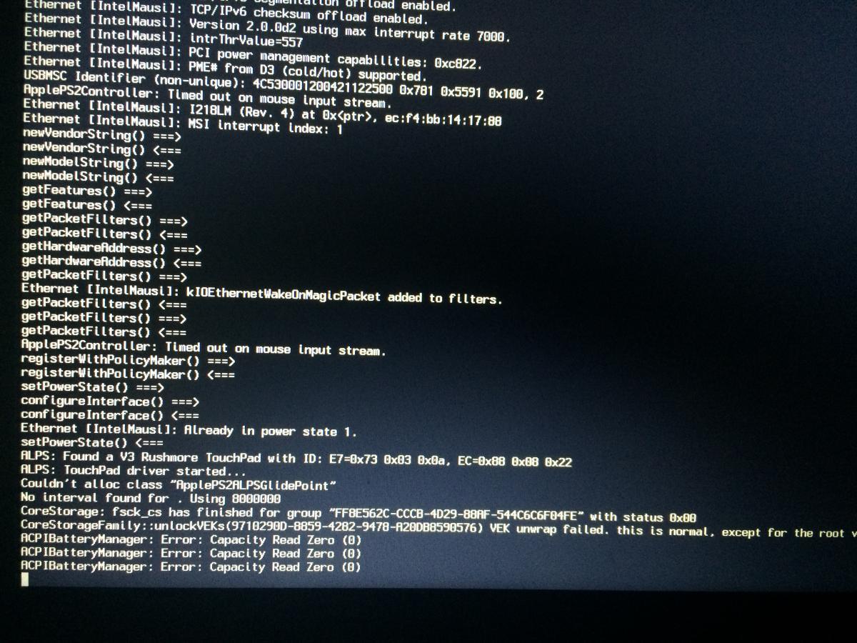

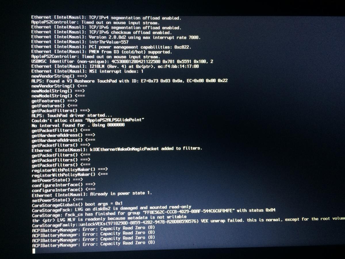

fwz.mhmd Posted July 17, 2017 Author Share Posted July 17, 2017 I'm so stupid. When you mentioned USB wireless, I relized i had one plugged so I removed it and got new error (safe mode). Then i tried single user. Link to comment Share on other sites More sharing options...
Moderators Jake Lo Posted July 17, 2017 Moderators Share Posted July 17, 2017 what happens after this error? does it auto reboot or keep same error continuously? try removing ACPIBatteryManager.kext in /EFI/Clover/kexts/Other Link to comment Share on other sites More sharing options...
