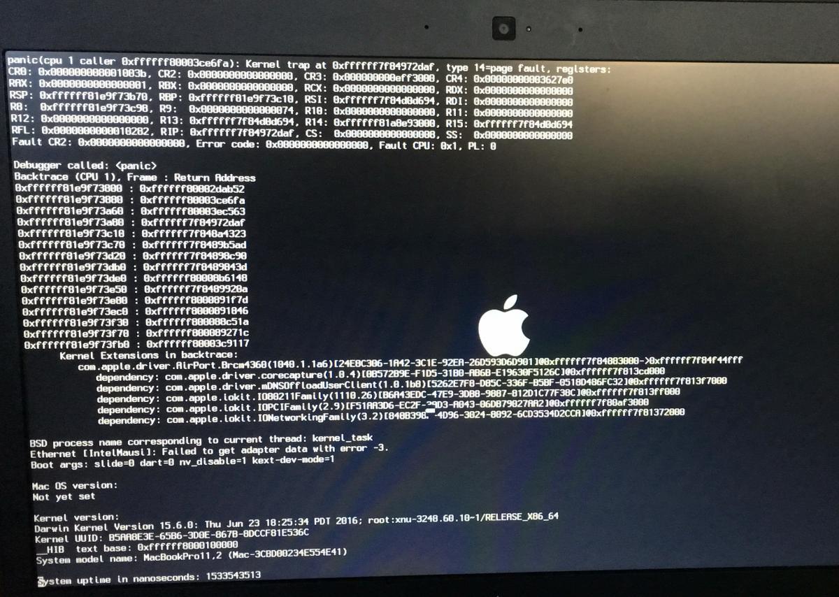

Ryan_Gabriel Posted August 10, 2017 Share Posted August 10, 2017 Omg so frustrated. I'm using this guide by Jake Lo (which points to this guide, also by Jake) I've set my DVMT to 0x03 using the EFI shell method, and verified that it's correct. I had to manually specify the boot entry in my BIOS because the USB drive wasn't showing up, but Clover loads fine. When I select to install Mac OS I get a kernel panic: Machine specs: BIOS 1.16.4 16 GB RAM (2 x 8GB) Core i7-6600U SATA SSD DW1830 WiFi card Set to AHCI / UEFI / Secure Boot = off What am I doing wrong here...? Please and thank you, I'm really excited to get this working. -Zak- Link to comment Share on other sites More sharing options...
Moderators Jake Lo Posted August 11, 2017 Moderators Share Posted August 11, 2017 Have you tried the alternate bootpack? Link to comment Share on other sites More sharing options...
Ryan_Gabriel Posted August 11, 2017 Author Share Posted August 11, 2017 When I tried E7470_v1.15.4_alternate.zip Clover didn't show any bootable partitions... I'll also try E7470_BIOSv10.15.4.zip. Does it make any difference that I'm trying to install El Capitan and not Sierra? Link to comment Share on other sites More sharing options...
Ryan_Gabriel Posted August 11, 2017 Author Share Posted August 11, 2017 (Jake, thank you a million times over for building these guides and being actively helpful on the forums. I really appreciate it.) OK, so I Reset BIOS to default settings / verified AHCI / Secure Boot disabled Reset DVMT to 0x3 using the EFI Shell thumb drive Rebuilt my USB stick from scratch using the same guides with MacOS Sierra (freshly downloaded) Clover 4152 So far the install is working. (Edited to change this last bit, I forgot to replace the EFI root folder with the one you posted along with the boot packs. My bad!) Link to comment Share on other sites More sharing options...
Ryan_Gabriel Posted August 11, 2017 Author Share Posted August 11, 2017 OK, I figured it out. Up and running. Thank you! :D Link to comment Share on other sites More sharing options...
