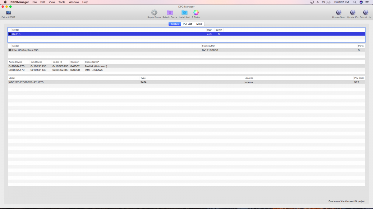

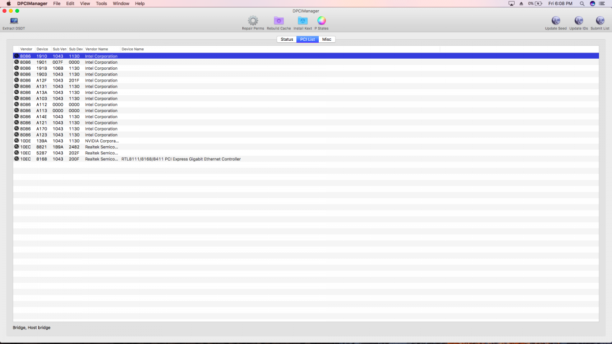

Moderators Jake Lo Posted August 26, 2017 Moderators Share Posted August 26, 2017 Now you'll need to patch your DSDT/SSDT to get the rest of the system working smoothly. Boot to Clover GUI, hit F4. Then continue booting to MacOS. Compress and attach /EFI/Clover/ACPI/Origin Screenshot of Status and PCI List with DPCIManager https://sourceforge....ts/dpcimanager/ Launch IOReg IORegistryExplorer_v2.1.zip, save and attach. Link to comment Share on other sites More sharing options...
SOJAY Posted August 26, 2017 Author Share Posted August 26, 2017 Sleep and wake working Intel HD 530 working but can't reduce or high the brightness Link to comment Share on other sites More sharing options...
SOJAY Posted August 26, 2017 Author Share Posted August 26, 2017 Thanks origin.zip IORegistry .zip Link to comment Share on other sites More sharing options...
Moderators Jake Lo Posted August 26, 2017 Moderators Share Posted August 26, 2017 Replace the files/folders in /EFI/Clover with the attached files and folders Copy the 2 kexts in /EFI/Clover/kexts/Other/LE to /Library/Extensions then repair permission and rebuild cache with the following commands, reboot sudo chmod -Rf 755 /L*/E* sudo chown -Rf 0:0 /L*/E* sudo touch -f /L*/E* sudo chmod -Rf 755 /S*/L*/E* sudo chown -Rf 0:0 /S*/L*/E* sudo touch -f /S*/L*/E* sudo kextcache -Boot -U / Hopefully this will allow audio, battery status and brightness control By the way, what bios version are you running? R510VX-2.zip Link to comment Share on other sites More sharing options...

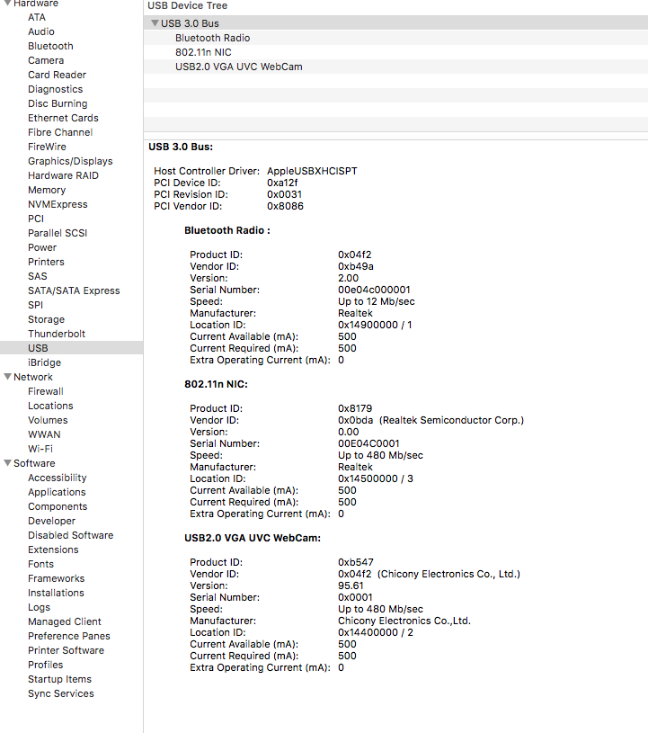

Moderators Jake Lo Posted August 26, 2017 Moderators Share Posted August 26, 2017 What wireless device does it have? see here Link to comment Share on other sites More sharing options...
SOJAY Posted August 26, 2017 Author Share Posted August 26, 2017 Do i need to update my bios? Link to comment Share on other sites More sharing options...
