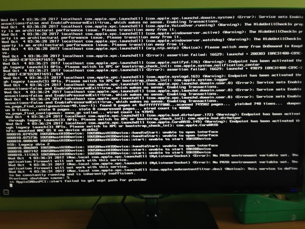

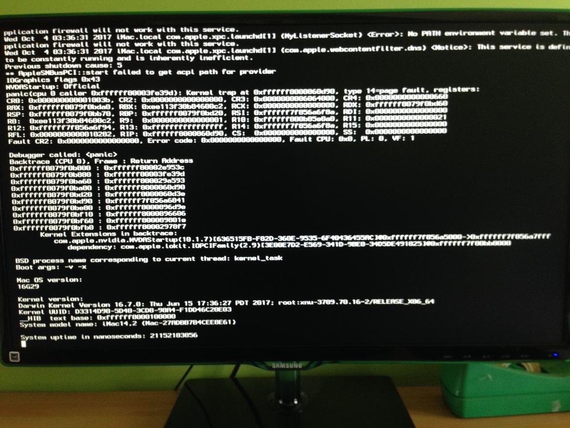

poesie100 Posted October 4, 2017 Author Share Posted October 4, 2017 I have now my CPU received that support the requirements for the SSE4 instruction set. (Intel core 2 duo e7600) But now When I boot I get the following error messages: ( see 2 screenshots in attachment) This is the clover folder from the installer USB for Sierra what I have tried: CLOVER.zip Any idea what the problem now is why I can't get to the install screen ? Link to comment Share on other sites More sharing options...
Administrators Bronxteck Posted October 4, 2017 Administrators Share Posted October 4, 2017 try booting with nv_disable=1 flag from clover boot GUI or disable graphics injection Link to comment Share on other sites More sharing options...
