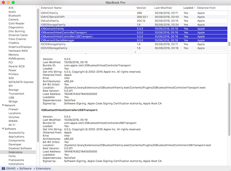

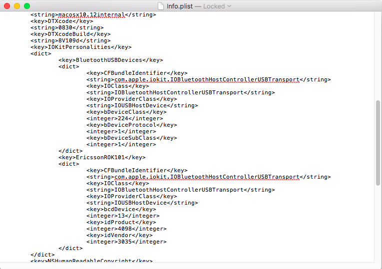

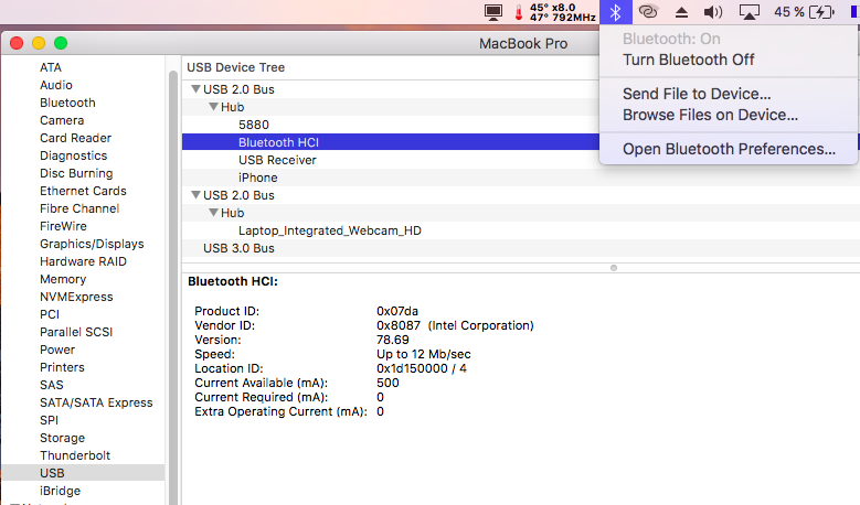

Administrators Hervé Posted October 27, 2017 Administrators Share Posted October 27, 2017 Atheros uses generic bluetooth drivers hence there is no option to turn BT on/off in macOS, it can be achieved only by the Fn+F2 keys combinations (In a few cases only, like ASUS) Old Dell DW3x0 modules were based on CSR chips and worked OOB without the options to turn them on and/or off through the BT icon in the Firnder's bar. Once their ids are added to the CSR transport kext, these options become available... You could try the same, there aren't that many transport PlugIn kext that apply here. Another example with the Intel combo wireless/Bluetooth card in my Latitude E6440. No support for the wireless but the BT module is supported OOB with the generic kexts. There are options to turn it on and off: 1 Link to comment Share on other sites More sharing options...
