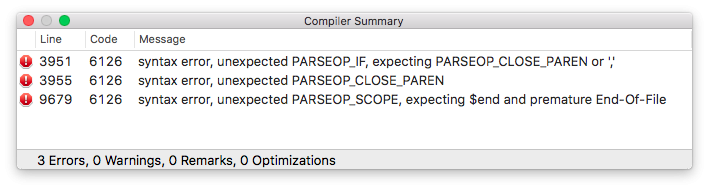

If you had been patching your own DSDT recently, you most likely encountered this common error dialogue
when clicking on the 1st 2 errors, they'll take you to these set of codes
If (LEqual (PM6H, One))
     CreateBitField (BUF0, \_SB.PCI0._Y0C._RW, ECRW)  // _RW_: Read-Write Status
     Store (Zero, ECRW (If (PM0H
                  CreateDWordField (BUF0, \_SB.PCI0._Y0D._LEN, F0LN)  // _LEN: Length
                  Store (Zero, F0LN)
To fix the errors,  I created this patch which you can just apply with latest version of MacIASL
# Fix IASL bug on some DSDT
into method label _CRS code_regex Store\s+\(Zero,\s+ECRW\s+\(If\s+\(PM0H\) replace_matched
begin
Store (Zero, ECRW) } If (PM0H)
end;
into method label _CRS code_regex Store\s+\(Zero,\s+F0LN\)\s+?\}\)\) replace_matched
begin
Store (Zero, F0LN)
end;
This will fix all 3 errors listed above. Enjoy!

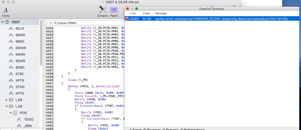

I have exact these 3 errors, (0x01 instead if One)
If (LEqual (PM6H, 0x01))
                    Store (Zero, ECRW (If (PM0H) --> this line marked error
                                Store (Zero, F0LN)
After did your patch, it came out 1 new error and many warnings
  • Moderators
Your DSDT.dsl has an extra "}"
Quote
                    Store (Zero, ECRW)} If (PM0H)
                                Store (Zero, F0LN)
                }  // You have an extra bracket here, remove it
After you remove that, you'll just need to rename
*pnp0c14
to
PNP0c14
After that you should be able to compile and save it as *.aml file. You can't boot with *.dsl file
I did fix these
                    Store (Zero, ECRW)
                If (PM0H)
                                Store (Zero, F0LN)
                If (LEqual (PM0H, 0x01))
                    CreateBitField (BUF0, \_SB.PCI0._Y0D._RW, F0RW)  // _RW_: Read-Write Status
                    Store (Zero, F0RW)
                CreateDWordField (BUF0, \_SB.PCI0._Y0E._MIN, M1MN)  // _MIN: Minimum Base Address
                CreateDWordField (BUF0, \_SB.PCI0._Y0E._MAX, M1MX)  // _MAX: Maximum Base Address
                CreateDWordField (BUF0, \_SB.PCI0._Y0E._LEN, M1LN)  // _LEN: Length
                ShiftLeft (TLUD, 0x14, M1MN)
                Add (Subtract (M1MX, M1MN), 0x01, M1LN)
                Return (BUF0)
1st 2 error disappeared. 3rd one still there
