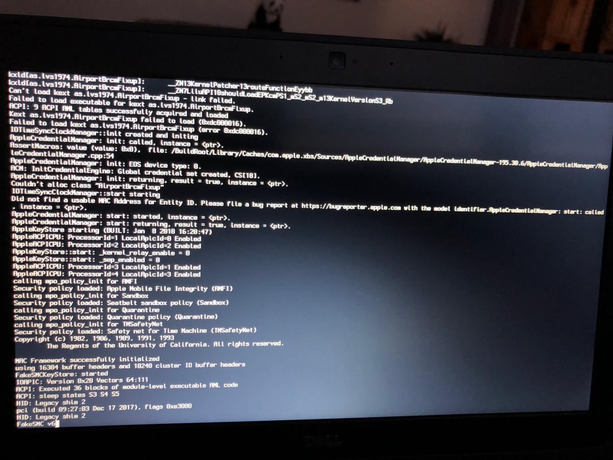

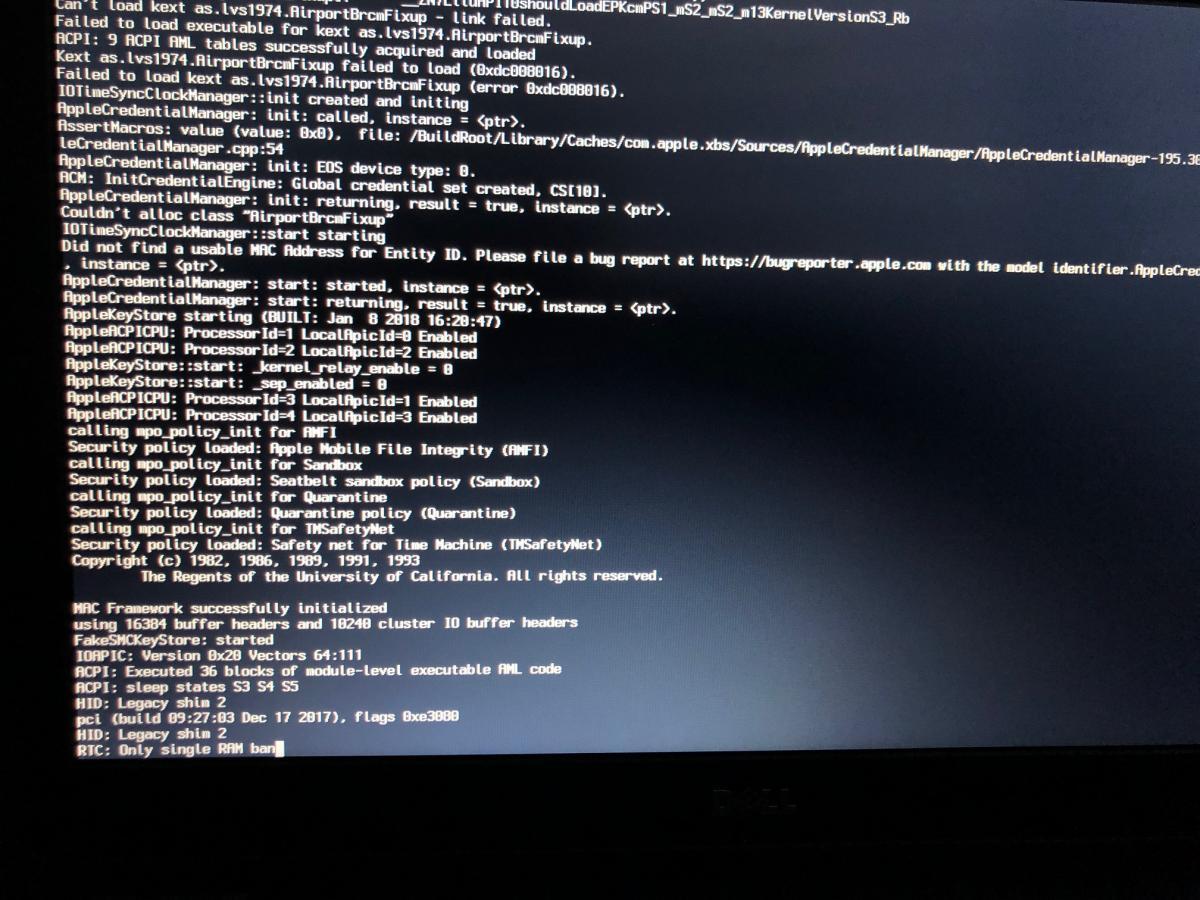

ricksimpson Posted February 7, 2018 Author Share Posted February 7, 2018 try lilu kext and airportbrcmfixup plugin. you might have to add to device section fake wifi id (device 0x04128086) / fix airport patch and dtgp to your clover config as well unless you have those clover patches already defined in dsdt. Hi Bronxteck, Thank you for your suggestion. Are you able to take me through steps of how to install it, and what specific kexts and patching I will need to apply to them. I believe because I have tried so many different ways I probably have kexts installed that I don't need. I have Bluetooth working however. Because I have mixed so many patches together I am bit confused. Cheers. Can't upload pictures due to a server issue - screen grabs have been uploaded to PhotoBucket instead. http://i50.photobucket.com/albums/f311/RickSimpsonSaturn/5_zpskubnigdu.png http://i50.photobucket.com/albums/f311/RickSimpsonSaturn/2_zpsn40m1ymf.png http://i50.photobucket.com/albums/f311/RickSimpsonSaturn/4_zps0vi35hfg.png http://i50.photobucket.com/albums/f311/RickSimpsonSaturn/3_zpswhcyohbs.png http://i50.photobucket.com/albums/f311/RickSimpsonSaturn/1_zps9ytxzinn.png Link to comment Share on other sites More sharing options...
Moderators Jake Lo Posted February 7, 2018 Moderators Share Posted February 7, 2018 the wifi fakeID is incorrect, that's for Haswell HD Graphics Try 0x433114e4 You could remove all those force kext to load, unnecessary. Uncheck AppleIntelCPUPM If this still doesn't work, then clear /EFI/Clover/ACPI/Origin Reboot to Clover GUI, hit F4 Continue to OSX, compress and attach /EFI/Clover/ACPI/Origin I'll patch the files for you. Link to comment Share on other sites More sharing options...
ricksimpson Posted February 8, 2018 Author Share Posted February 8, 2018 Hi Jake, Unfortunately no love. Have cleared origin folder and pressed F4. I have attached a ZIP containing my ACPI folder, and also my config file. Please advise if there are any issues with my config/kext patching. Thank you for patching this for me. Hope to hear soon. Cheers upload.zip Link to comment Share on other sites More sharing options...
Moderators Jake Lo Posted February 8, 2018 Moderators Share Posted February 8, 2018 Here you go. Replace the Config + the ACPI folder E7270_simpson.zip 1 Link to comment Share on other sites More sharing options...
ricksimpson Posted February 9, 2018 Author Share Posted February 9, 2018 Thank you sir all is functional Link to comment Share on other sites More sharing options...

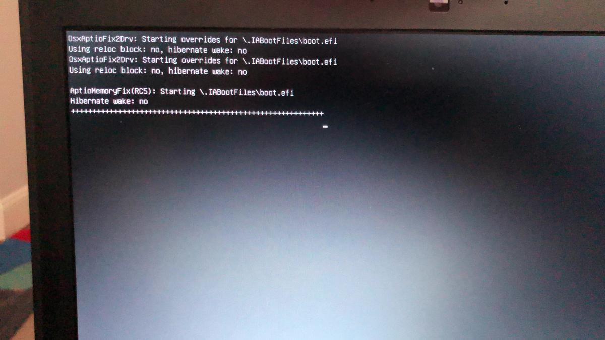

timlon Posted January 20, 2019 Share Posted January 20, 2019 Could you walk me through how to fix the ++++++++ issue? I tried replacing the config.plist and the OsxAptioFix3Drv-64.efi file. I have the boot loader on a separate flash drive and macOS Mojave ready to go on another USB stick. Hardware: Lenovo Ideapad 110 15-ISK Intel Core i3 6100U @ 2.3GHz 8GB DDR4 Ram Genuine Lenovo Motherboard Link to comment Share on other sites More sharing options...
