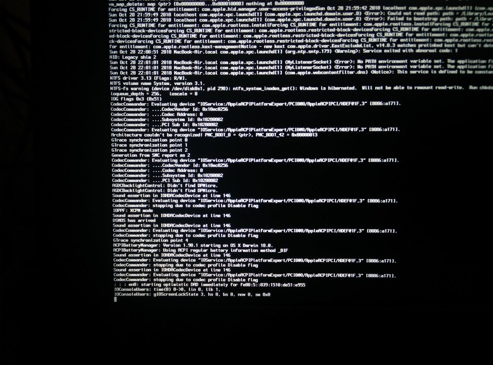

OlegZ Posted October 28, 2018 Share Posted October 28, 2018 Thank you for your reply. I followed the instructions and I see that it has moved forward a lot but then I am stuck at this screen. Something sound related but also the screen went completely black in a while. I have a 4K panel as a reminder. Do you have any ideas? Link to comment Share on other sites More sharing options...
Moderators Jake Lo Posted October 28, 2018 Moderators Share Posted October 28, 2018 Graphics issue. Try this Config config.plist.zip Link to comment Share on other sites More sharing options...

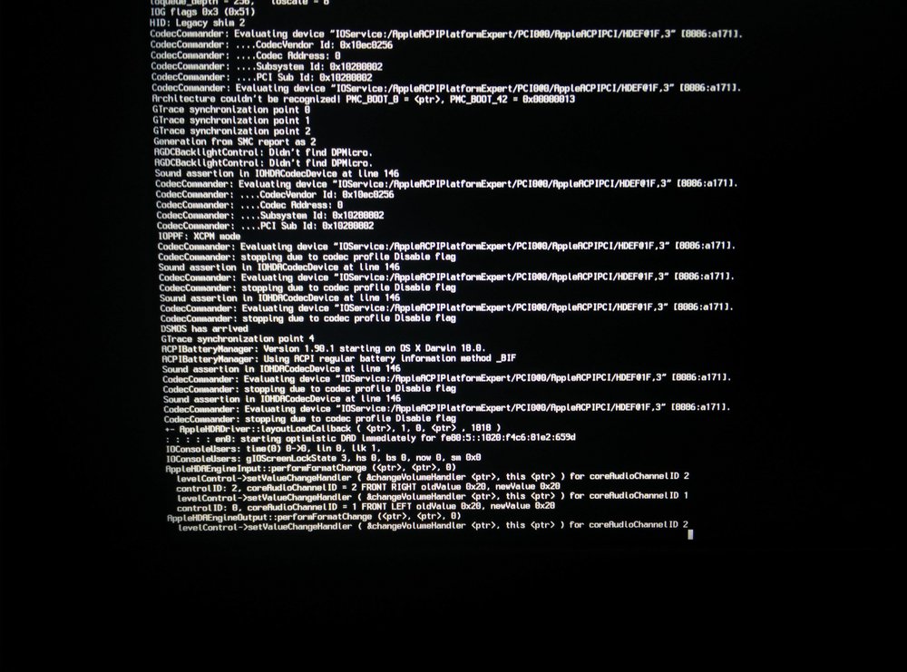

OlegZ Posted October 28, 2018 Share Posted October 28, 2018 I had to set also *_platform_id to 0x12345678 and select InjectIntel in Clover to make it going. Only fakeID didn't work. It is a big progress for me. For now I'll make this change permanent in config.plist. Thank you very much, Jake!!! But could you direct me to how to resolve Intel GPU acceleration? I am afraid in 4K CPU will burn to death in software rendering. Link to comment Share on other sites More sharing options...
OlegZ Posted October 29, 2018 Share Posted October 29, 2018 There is an update on the situation. I had kernel panic and it turned out that in Clover command line I had nv_disable=1 and debug=100 without dashes. Anyway, when I added dashes I did not receive kernel panic but also I did not see any picture but I could hear sound coming and notebook reacting to key presses. Also I had this messages saying that GPU initialized and works. Now when in Mac OS I can still see 2 adapters and I can see that Intel 630 has only 32 MB of VRAM. Kext is not loaded. Ethernet works, sound works, touchpad works, Bluetooth even works, all USB ports work. Jake, could you instruct me what must be done in this situation? Thank you in advance. Link to comment Share on other sites More sharing options...
