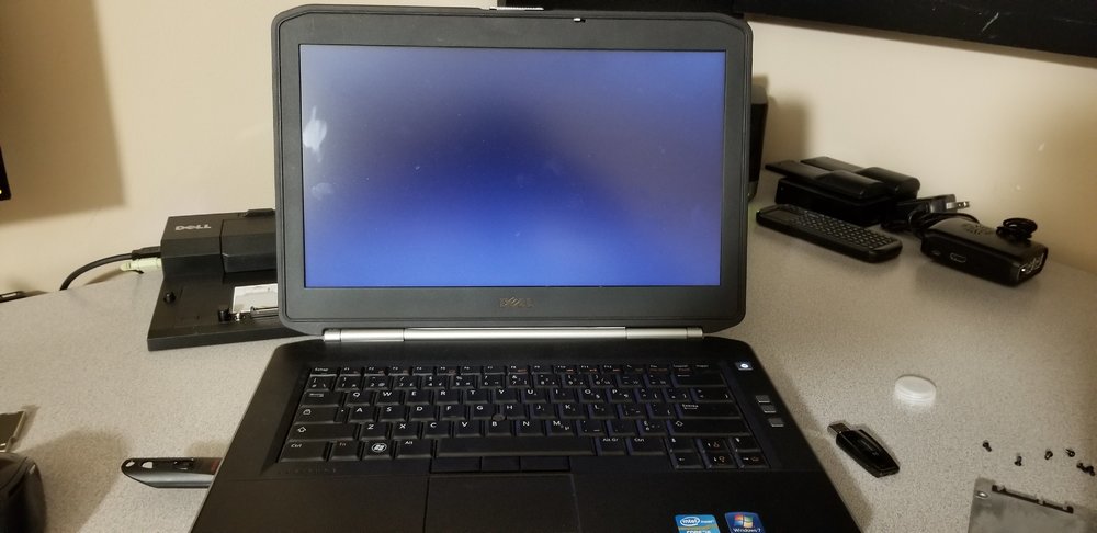

I don't have wireless, (my card is supported) but needs patching, I will test sd card and hdmi tomorrow. I can't test display port on the dock
-DVI port is good (dual display)
-LAN is good
-Sleep and wake is good
6 hours ago, Jake Lo said:
Try adding AirportBRCMFixup.kext to /EFI/Clover/kexts/Other
If still fails, then try adding FakePCIID.kext + FakePCIID_Broadcom_Wifi.kext to the same location
adding  AirportBRCMFixup.kext to clover worked out great.. one last question is it possible to get the audio jack from the dock to work? I have the dell dock PR03X, if not its all good this is awesome the way it is..
