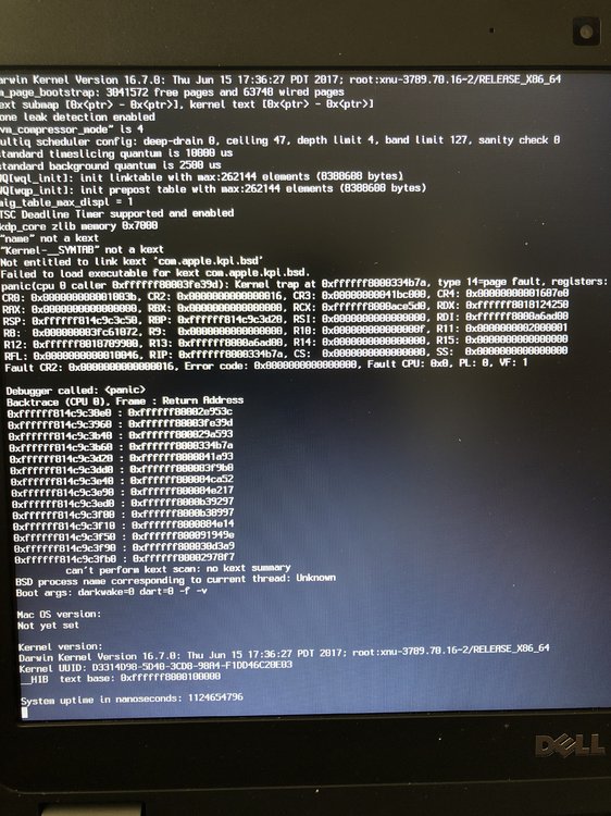

michaelo1981 Posted April 11, 2018 Author Share Posted April 11, 2018 Verbose mode still shows this: Link to comment Share on other sites More sharing options...

Administrators Hervé Posted April 11, 2018 Administrators Share Posted April 11, 2018 JakeLo beat me to it but here's your DSDT patched with: Minor syntax corrections (e.g.: renaming of "_T_x" to "T_x", renaming of "*pnpc13" to "PNPC13") EHCx USB2 controller devices renaming to EH0x (for USB2.0 ports) B0D3 device renaming to HDAU (for HDMI audio) GFX0 device renaming to IGPU (for integrated HD4600 GPU) _DSM method injection to IGPU device to fake desktop HD4600 id 0x0412 and inject Azul FB #12/layout id 0x0a260006 "Darwin" check injection to ensure XHC/USB3.0 controller native recognition IRQs 0,8,11 exclusion off HPET device to fix USB issues _DSM method injection to HDEF device to declare ALC292 audio codec There are probably a few more patches to inject to fix Sleep/Wake eventual issues, but you can already give that patched DSDT a try... DSDT.aml.zip When you 1st boot, use the following options and flags: KernelBooter_kexts=Yes -f -v CsrActiveConfig=3 Link to comment Share on other sites More sharing options...
michaelo1981 Posted April 11, 2018 Author Share Posted April 11, 2018 This is where it gets to without -f in verbose mode before the non responsive apple progress bar 54517316520__ED68990F-63E1-41D6-8F1D-33E05D74263E.MOV Link to comment Share on other sites More sharing options...
michaelo1981 Posted April 11, 2018 Author Share Posted April 11, 2018 I gave the one jack gave me a try. Still having same issue. Please look at photo I attached as well as the video i just attached Link to comment Share on other sites More sharing options...
