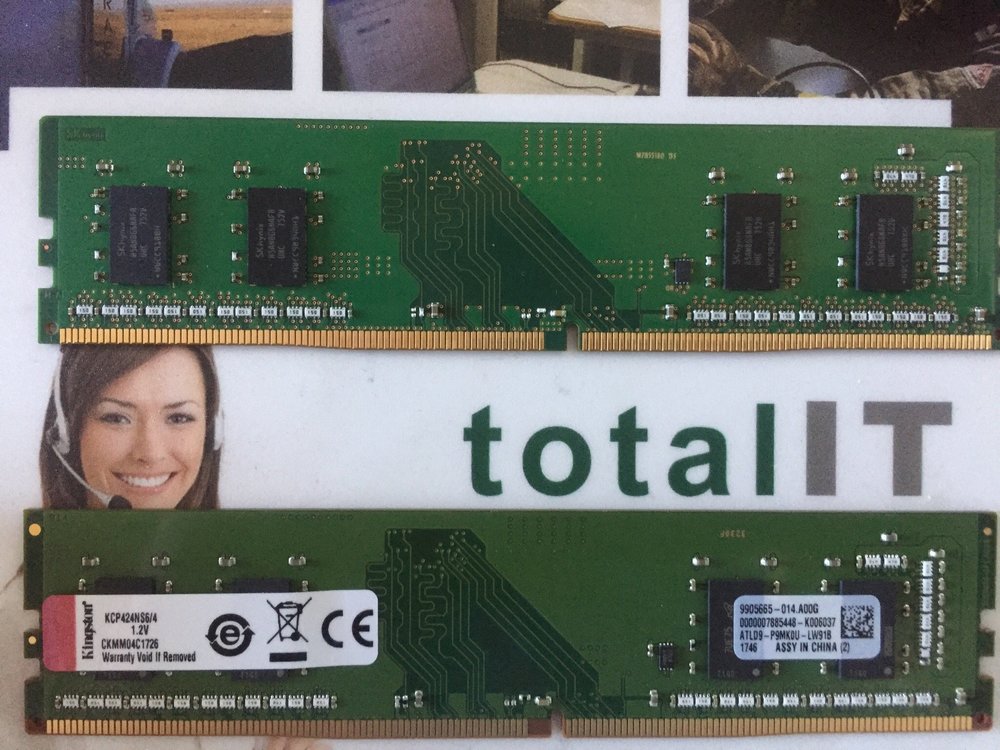

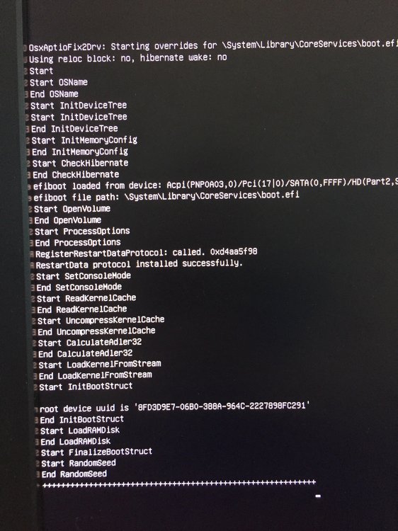

Alexander Kupriyanov Posted June 26, 2018 Share Posted June 26, 2018 System specs: Dell optiplex 3050 SFF Core I5 6500 (6th gen)/3.2 ghz 4 core Intel 250 express Intel HD graphics 630 4gb DDR4 2400 mhz 128gb SSD Sata Realtek Ethernet Realtek HD audio/Intel display audio With 4gb memory system works fine, but after adding additional memory module 4 gb, system begins restarting progress in the moment of starting till the white progress bar appears . PS: Also anyone knows how to run internal audio ALC3234? EFI.zip Link to comment Share on other sites More sharing options...

Moderators Jake Lo Posted June 27, 2018 Moderators Share Posted June 27, 2018 Remove OsxAptioFix2Drv and replace with AptioMemoryFix when you reinstall Clover Link to comment Share on other sites More sharing options...
Alexander Kupriyanov Posted June 27, 2018 Author Share Posted June 27, 2018 same troubles Link to comment Share on other sites More sharing options...
