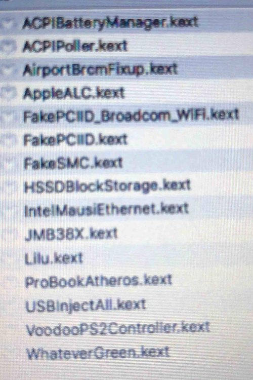

ssprod Posted September 5, 2018 Author Share Posted September 5, 2018 Thanks again. I've re-installed High Sierra and still no change. The card is recognized in DPCI, but not showing up in OSX at all. These are my kexts currently in EFI/Clover/kexts/Other. Update: I reversed the leads on the wifi card, and it's working now with these kexts. I'd be glad to post my EFI, however I seem to be limited to under 2megs for upload. Thanks Jake ! Link to comment Share on other sites More sharing options...
