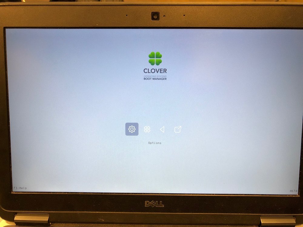

moon safari Posted October 12, 2018 Share Posted October 12, 2018 Hello community! I have a problem during boot mac os mojave, i create my bootable usb drive with unifail with uefi mode i check debug mode butboot stop at : Waiting on on dict ID=0 My configuration is: intel i5 4310U with 16gb of ram, and two samsung msata ssd Sorry for my bad English I'm french ^^ Link to comment Share on other sites More sharing options...

Moderators Jake Lo Posted October 12, 2018 Moderators Share Posted October 12, 2018 Try this, replace the contents into /EFI/Clover Make sure you reset your BIOS to Load Default, Apply. Then go back and set to UEFI/AHCI/Secure Boot Disable If it's still not working, post your Clover folder E7240_Mojave.zip Link to comment Share on other sites More sharing options...
moon safari Posted October 12, 2018 Author Share Posted October 12, 2018 thank for your answer, i try this at the boot clover don't find mac os installer Link to comment Share on other sites More sharing options...
Administrators Bronxteck Posted October 12, 2018 Administrators Share Posted October 12, 2018 did you install clover apfs driver? what samsung ssd are they some OEM ones have issues. Link to comment Share on other sites More sharing options...
Moderators Jake Lo Posted October 12, 2018 Moderators Share Posted October 12, 2018 You need to add HFSPlus.efi into /EFI/Clover/Drivers64UEFI See my Clover guide here with link to files Link to comment Share on other sites More sharing options...
moon safari Posted October 12, 2018 Author Share Posted October 12, 2018 Thanks, i will try tomorrow Link to comment Share on other sites More sharing options...
moon safari Posted October 13, 2018 Author Share Posted October 13, 2018 hello, I try this and it works! thank you! Wifi end bluetooth don't work but i read on other forums that Intel AC-7260 is not supported, do you know an other wifi and bluetooth card that working with osx? Link to comment Share on other sites More sharing options...
