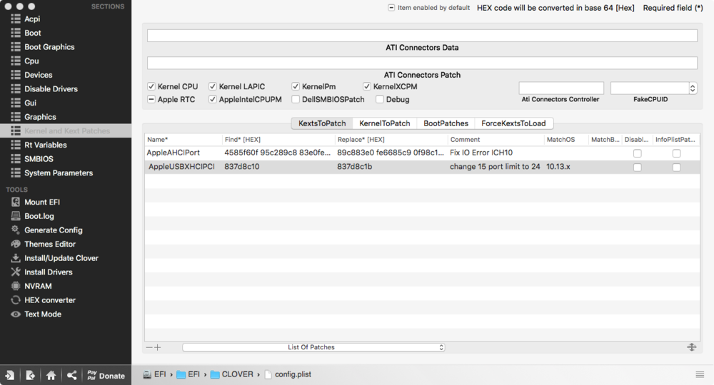

RamiTrainFan Posted October 30, 2018 Share Posted October 30, 2018 So i downgraded and installed Niresh 10.13 and then installed the 10.13.2 Combo. And now my USB is not working. I have the patch. USBInjectAll.kext and even FakePCIID_XHCIMux.kext Idk if i spelled that right. Here are some screenshots EDIT: I'm using a Latitude E7240. And the SMBIOS is MBP11,1 Link to comment Share on other sites More sharing options...
Moderators Jake Lo Posted October 30, 2018 Moderators Share Posted October 30, 2018 837d8c1b is for 100 series chipset. Try 837d8c16 instead Why 10.13.2 and not the latest 10.13.6 ComboUpdate??? Bad idea to have NullCPUPowermanagement.kext Bad idea to have 2 PS2 controller and in 2 different locations. My guess is you have it in /S/L/E and /L/E... VoodooPS2ControllerALPS.kext VoodooPS2Controller.kext VoodooHDA and disabler...more bad idea. Link to comment Share on other sites More sharing options...
RamiTrainFan Posted October 30, 2018 Author Share Posted October 30, 2018 I just updated to 10.13.6 and put the USB patch, Still no luck Link to comment Share on other sites More sharing options...
