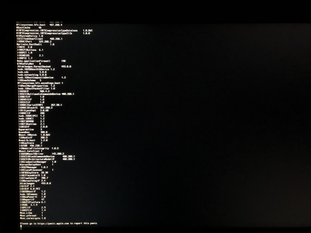

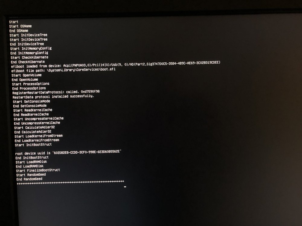

punjabigator Posted December 20, 2018 Author Share Posted December 20, 2018 Jake, the 7040_Mojave folder has config file and kexts only! Also - I used F4 to dump the files in the origin folder and then used only the DSDT in the patch folder. Now I can boot but then no video either HDMI or Display Port. Also this unit has Nvidia Card, which I disabled in the config! Please elaborate on this "You might have to install with FakeID for IntelGFX 0x12345678". Also should update the BIOS to its current version? Thank for your help. Link to comment Share on other sites More sharing options...
Moderators Jake Lo Posted December 20, 2018 Moderators Share Posted December 20, 2018 1) Don't need DSDT, that's why I didn't include it 2) How do you disable in Config? nv_disable=1? NOT enough, either disable in BIOS, with DSDT Patching or remove it 3) If you encounter FB error during boot, either set DVMT in BIOS or use FakeID 4) Update / not Update bios, your choice Link to comment Share on other sites More sharing options...
