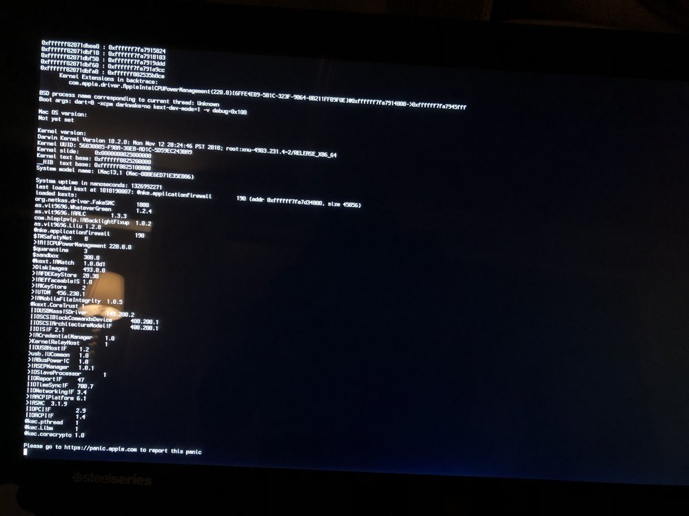

punjabigator Posted December 24, 2018 Share Posted December 24, 2018 Hello OSX Family, As a Christmas present, I am helping my nephew to install Mojave on his Dell Optiplex 9010 AIO. I started off with the Jake's guide of Optiplex 9020. The specs are as follows: 1. Model - Optiplex 9010 AIO 23 inch 2. Processor - Intel i7-3770s 3. Graphics: Intel HD 4000 4. 500 GB HDD 5. BIOS: A23 SO far - I was able to boot using the attached Working_EFI and install went very well. I can boot natively using this Working_EFI, however, if I make any change to the working EFI to obtain matched SMBIOS and inject correct graphic card I get a kernel panic. I tried several options but no success so far. Can someone please review the attached both EFIs and let me know what am I doing incorrectly. Permission ran after every change or reboot. Thank you. EFI.zip Working EFI.zip Link to comment Share on other sites More sharing options...

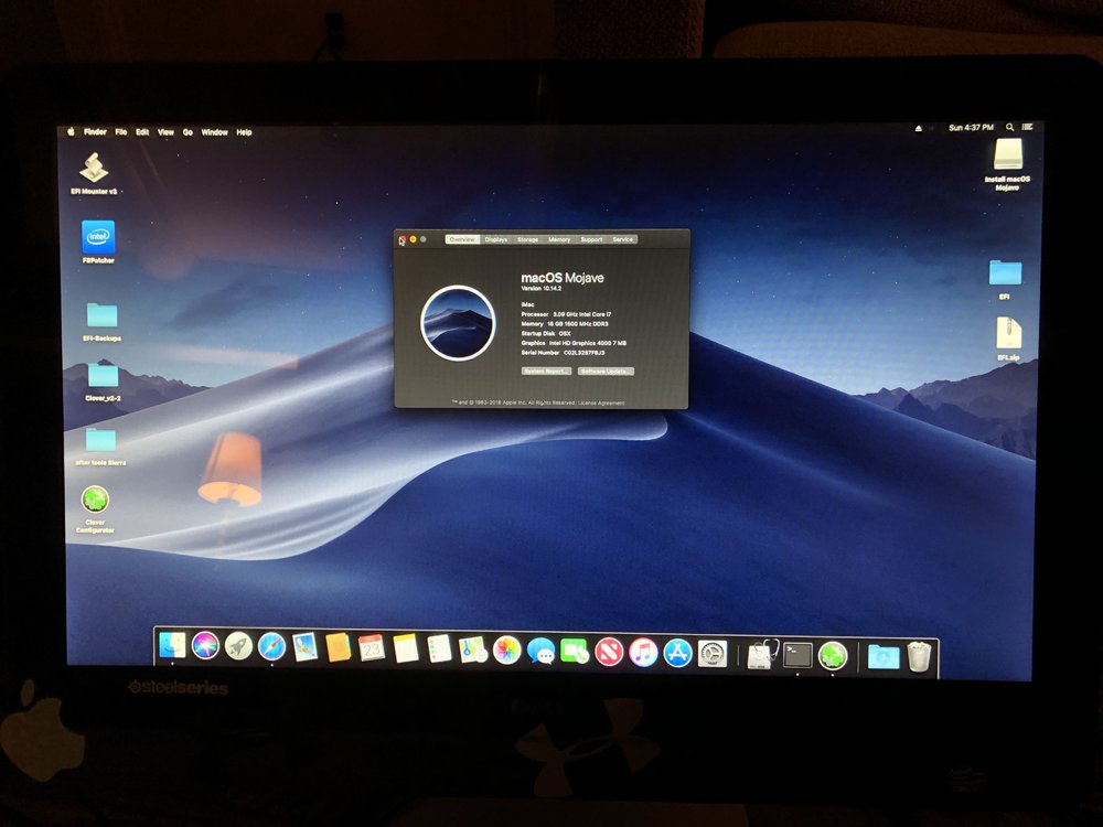

punjabigator Posted December 24, 2018 Author Share Posted December 24, 2018 Update - I was able to boot using config.plist/KernelAndKextPatches/KernelXCPM=true . I am still struggling to get the QE/QC to work. Thank you for providing suggestions. Happy Holidays update 2 - whatever green fixed QE/QC. Link to comment Share on other sites More sharing options...
