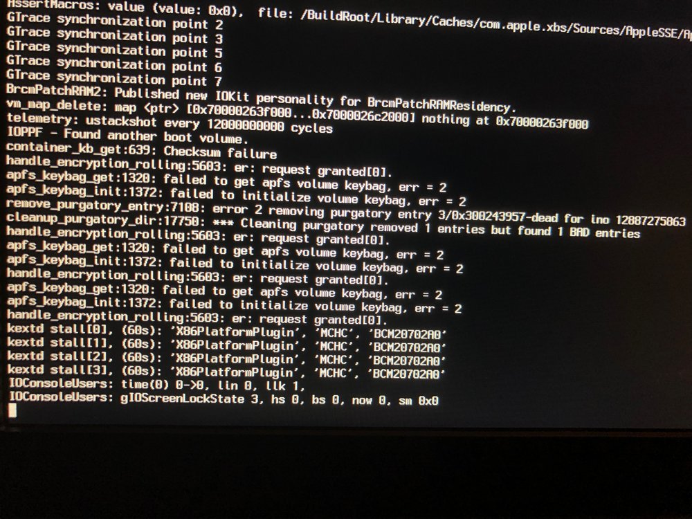

MrJonesIII Posted March 6, 2019 Author Share Posted March 6, 2019 Hi, Now having a strange problem where a perfectly working system somehow ends up trying to sleep, and then refuses to boot again, with the boot-up progress bar getting to about 80% and then stopping. I've forced power off and restarted in verbose mode and took a photo of the bit where it gets stuck. Any suggestions on how I can fix this without having to wipe it all and start again? Thanks, MJJ Link to comment Share on other sites More sharing options...
Moderators Jake Lo Posted March 6, 2019 Moderators Share Posted March 6, 2019 Check BIOS, make sure Optimus is enabled. Link to comment Share on other sites More sharing options...
MrJonesIII Posted March 6, 2019 Author Share Posted March 6, 2019 Hey Jake, Thanks so much! That's exactly what was wrong with it. How did the BIOS settings change? Was it the act of me accidentally putting it to sleep that caused it? MJJ Link to comment Share on other sites More sharing options...
