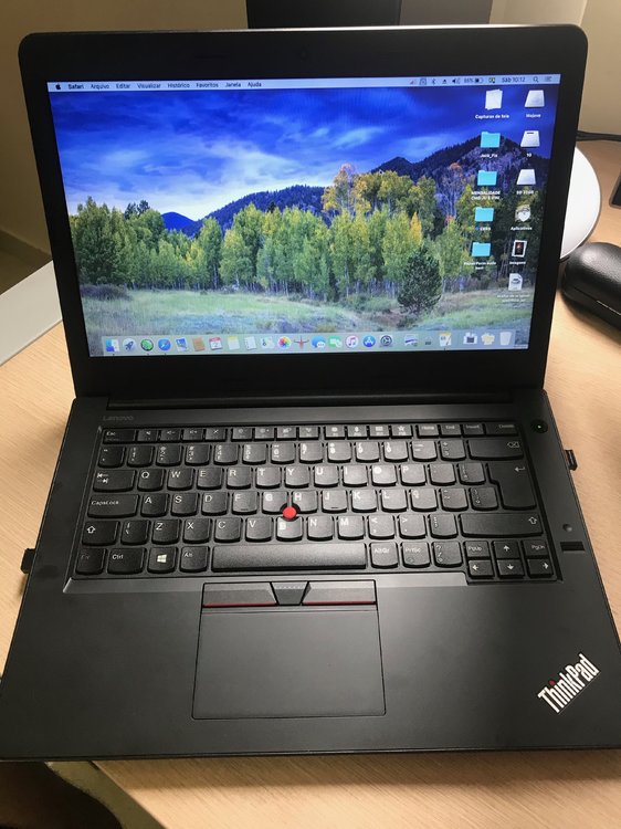

Hi my friends!!! I wish share my Clover folder that im pass hours and weeks to get install High Sierra (works with Mojave too).
Im use Create Install Media to prepare usb boot, install Clover bootloader and replace my clover folder.
That great  @Jake Lo  help me with very much!!!
Works
Ethernet
Audio with AppleALC.kext. Help from Mirone
Brightness works slide and Keyboard F5 F6 with DSDT compiled by Jake Lo!!!!
Bluetooth works like a charm.
HDMI fix display colors and audio
Battery display works fine, and percent is correct.
Trackpoint works too, with version by Jake Lo!!!!
Trackpad works very good, inclusive the buttons
SD Card works very awesome with @Jake Lo config.plist add ID on Devices.
HD intel 620 video onboard no more Glitches compiled by Jake Lo!!!!
Power off, restart  and sleep works fine too, thanks Jake Lo for DSDT
Now works perfect
Im have issue with Keyboard key "?" and "/" but im add English Keyboard 105 alt with Brazilian Keyboard ABNT2 and works.

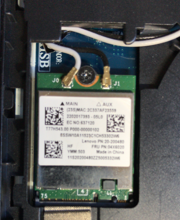

Wireless card need replace for compatible with M.2 NGFF because Qualcomm not works.
My wireless and bluetooth card replaced for this card and work with my kexts on post.
