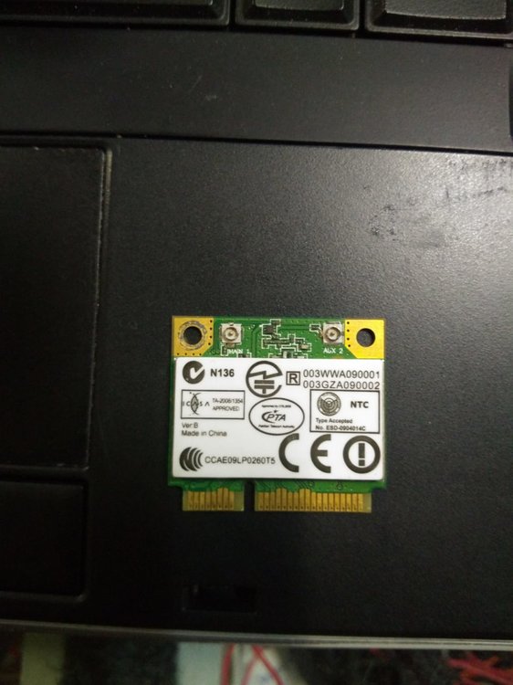

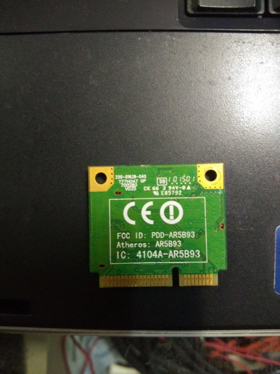

Leook Posted March 26, 2019 Share Posted March 26, 2019 In my laptop I installed this WIFI module to replace the original non-compatible one for $ 8. Link to comment Share on other sites More sharing options...
Moderators Jake Lo Posted March 26, 2019 Moderators Share Posted March 26, 2019 You have an Intel Wireless card, it has an Intel chip. Replacing with an Atheros like @Leook has is fine but I don't recommend it as Mojave no longer supports it and requires rolling back kexts. I recommend DW1510 or DW1550 as stated above. Link to comment Share on other sites More sharing options...

Leook Posted March 26, 2019 Share Posted March 26, 2019 However Jake Lo is right if you need to replace the module you should take a DW1510 or DW1550. Link to comment Share on other sites More sharing options...
