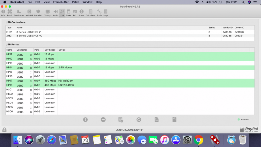

Definitely sounds like a USB-related issue. If your laptop has older USB2.0 controller, temporarily boot with USBInjectAll kext before running Hackintool so that you do not miss any controller/ports.

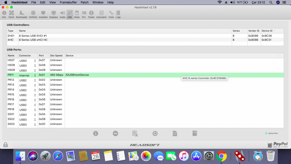

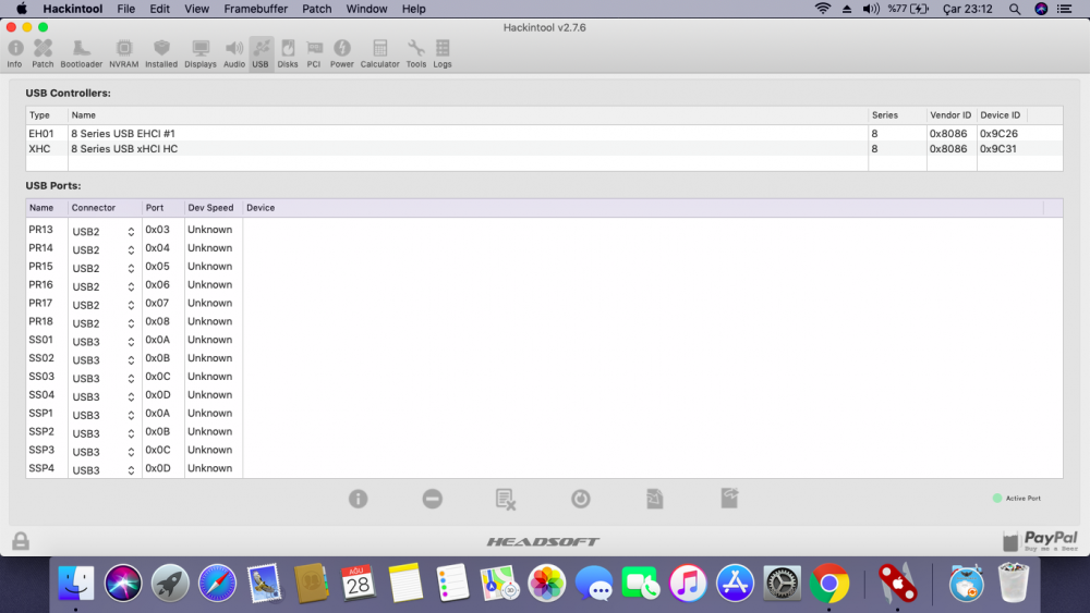

Install USBInjectall.kext to Clover kexts
Reboot, launch Hackintool
Test each port with USB 2.0 and USB 3.0 devices. Change Connector type accordingly
Make sure Webcam, Bluetooth, SD card shows as Internal
When done, delete all non highlighted ports.
Click the export button. This generates an USBPorts.kext and SSDT-xxx.aml
Use only 1 or the other, not both.
If use USBPorts.kext, then place in Clover kext, remove USBInjectAll.kext and disable the port limit patches
If use SSDT-xxx.aml, then place them in ACPI/Patches, keep USBInjectAll.kext and disable the port limit patches
