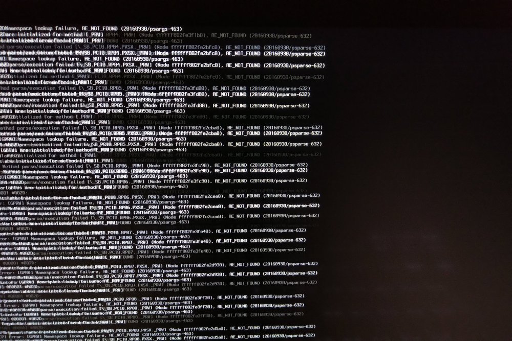

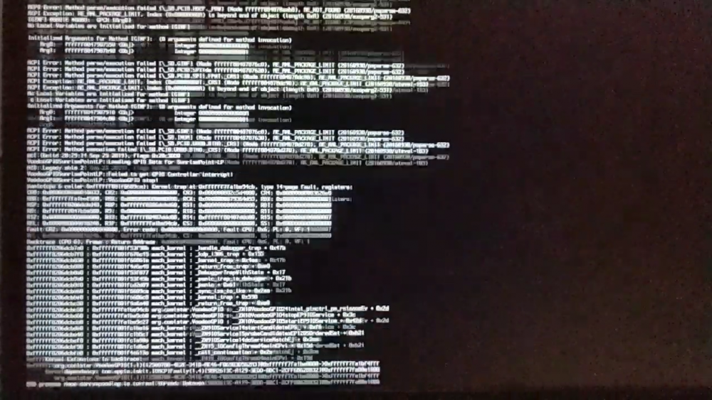

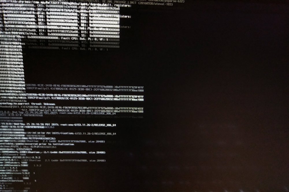

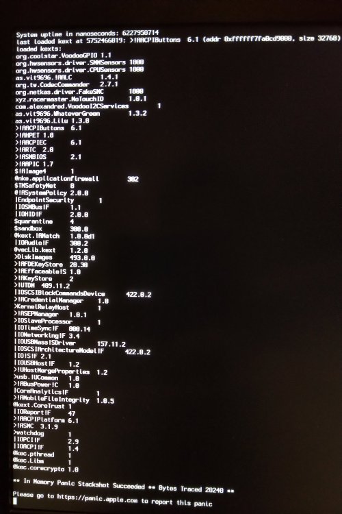

marv Posted October 23, 2019 Author Share Posted October 23, 2019 18 hours ago, Jake Lo said: Did you add the DSDT.aml back? No, I didn't. I added it back now for testing. With the DSDT.aml in place, the system doesn't reach the LoginManager anymore. It crashes during boot. It looks like the driver VoodooGPIO fails to get the GPIO controller interrupt and after that the Kernel panics. I attached some pictures, but I didn't get them in better quality because of the scroll speed. 18 hours ago, Jake Lo said: What wireless device does it have? It has an "Intel(R) Dual Band Wireless AC 8265, REV=0x230", but I learned from 11 hours ago, Hervé said: It must have been said a million times: Intel wireless are not supported. that it will not work. 18 hours ago, Jake Lo said: Post your Clover folder for review CLOVER.tar.gz 11 hours ago, Hervé said: 1) Does the laptop reset when operating standalone or docked? Both. 11 hours ago, Hervé said: 2) Lenovo Dock ??? Is this compatible? As a Thunderbolt 3 Dock it works in Linux and Windows without problems. With the new Catalina installation, DisplayPort and USB seem to be working as well 11 hours ago, Hervé said: 3) you'd have to specify what hardware you're talking about for that NIC, we're not going to guess... I think it's a Realtek R8152 (version 0x6010/RTL_VER_09) USB device: T: Bus=06 Lev=01 Prnt=01 Port=00 Cnt=01 Dev#= 2 Spd=5000 MxCh= 0 D: Ver= 3.00 Cls=00(>ifc ) Sub=00 Prot=00 MxPS= 9 #Cfgs= 2 P: Vendor=17ef ProdID=3069 Rev=31.03 S: Manufacturer=Lenovo S: Product=ThinkPad TBT3 LAN S: SerialNumber=301000002 C: #Ifs= 1 Cfg#= 1 Atr=a0 MxPwr=288mA I: If#=0x0 Alt= 0 #EPs= 3 Cls=ff(vend.) Sub=ff Prot=00 Driver=r8152 I also noticed in the logs, that when the system is running without the DSDT (only for about 8-10 minutes), these were always the last messages before the system boots again: Oct 21 20:26:40 Benjamins-MBP xpcproxy[553]: libcoreservices: _dirhelper_userdir: 557: bootstrap_look_up returned (ipc/send) invalid destination port Oct 21 20:29:13 Benjamins-MBP com.apple.xpc.launchd[1] (com.apple.xpc.launchd.domain.pid.mdmclient.570): Failed to bootstrap path: path = /usr/libexec/mdmclient, error = 108: Invalid path And I get a lot of these: Oct 23 20:00:32 Benjamins-MacBook-Pro Terminal[298]: assertion failed: 19A602: libxpc.dylib + 86780 [2E9076CD-6C0E-38B6-8403-B2DDCE125FBF]: 0x89 Oct 21 21:17:04 Benjamins-MacBook-Pro systemstats[66]: assertion failed: 19A602: systemstats + 188570 [84B69988-AB33-3F38-AA3B-B31D9FA23C20]: 0x0 Link to comment Share on other sites More sharing options...
