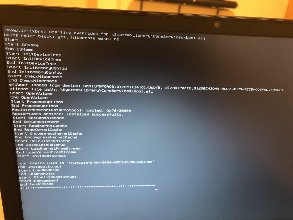

Tal Rahav Posted August 6, 2018 Share Posted August 6, 2018 Thanks. this is what happens. Link to comment Share on other sites More sharing options...
Moderators Jake Lo Posted August 6, 2018 Moderators Share Posted August 6, 2018 Did you follow the 1st post? Guide to create installer and bootpack included (Clover v2) Link to comment Share on other sites More sharing options...

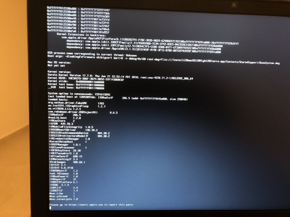

Tal Rahav Posted August 7, 2018 Share Posted August 7, 2018 Ok I figured it out. I needed to install clover into the EFI partition of the bootable installer high Sierra usb with this additions nstall for UEFI booting only Install Clover in the ESP Drivers64UEFI\OsxAptioFixDrv-64 Which I now did. But it is still doesn’t work if I try to run the installation from the boot menu it shows the Apple logo for a few seconds and than restarts. so I tried to run it with -v debug=0x100 and this is what I get. I think that the version of the high Sierra installation is 10.13.6 (downloaded it with the high Sierra patcher tool) should I try to use 10.13.0? Or it has nothing to do with the version? Link to comment Share on other sites More sharing options...
Moderators Jake Lo Posted August 7, 2018 Moderators Share Posted August 7, 2018 No, looks like it's the Clover loader issue. What BIOS version are you running? Did you set the BIOS to load Defaults, apply and then set it to? UEFI, AHCI, Legacy Option ROMs disabled, Secure Boot Disabled, wake on LAN disabled Reboot to Clover, press F4 at the GUI. Now compress and attach the Clover folder here for review. Link to comment Share on other sites More sharing options...
