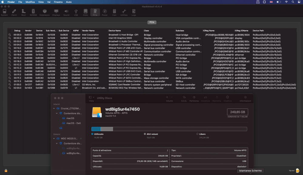

acquarius.13 Posted August 24, 2020 Author Share Posted August 24, 2020 Hi Jake, Thanks a lot! I had a first trial yesterday but it seemed to me not to work. Hackintool is recognizing it properly but it seems not work. I would like to try with another SD card ASAP (I had only one available yesterday) and then give a complete feedback. EDIT: I confirm that with other SD cards I have no working reader. It is properly recognised but it isn't working. In the attached picture it is clearly shown: I have a 16GB SD card attached (yesterday it was a 32GB SDHC card). I attach also my ioreg file for research and development. marco’s MacBook Pro.ioreg Link to comment Share on other sites More sharing options...
Moderators Jake Lo Posted August 26, 2020 Moderators Share Posted August 26, 2020 Assuming you have added the patch correctly, it's not reflecting in the IOReg file. Please note when you make any changes in OC, you need to select 'Reset NVRam' during OC picker. If it's not display, then press the spacebar. If it's still not working, then post your Config file for review Link to comment Share on other sites More sharing options...
acquarius.13 Posted August 26, 2020 Author Share Posted August 26, 2020 Hi Jake, you were doubly correct: I didn't add the patch correctly and I didn't perform a NVRAM reset. So, after doing those 2 things, SD card reader is working again in Big Sur. I updated the EFI folder in post #1. Thanks again! Link to comment Share on other sites More sharing options...
