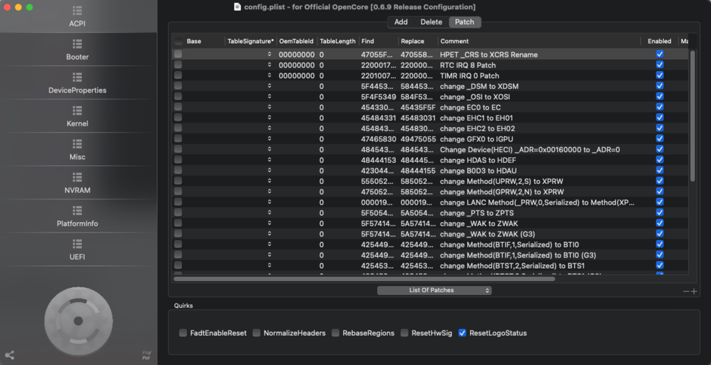

angelts Posted February 4, 2021 Author Share Posted February 4, 2021 I make new EFI with OpenCore 0.6.6 (my WI-FI card is BCM94352HBM) EFI-0.6.6.zip 1 Link to comment Share on other sites More sharing options...

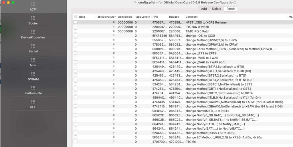

angelts Posted May 5, 2021 Author Share Posted May 5, 2021 OC 0.6.9 for test EFI.zip 1 Link to comment Share on other sites More sharing options...

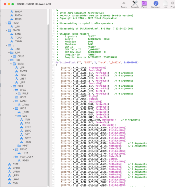

Baio77 Posted May 6, 2021 Share Posted May 6, 2021 can you post Ioreg of your configuration? I would like to merge ALL SSDTs into one SSDT , to do this I need ioreg like this Link to comment Share on other sites More sharing options...
angelts Posted May 6, 2021 Author Share Posted May 6, 2021 My IORegistryExplorer (ver. 3.0.2) save from today. I use Rehabman SSDT (modified) or my custom made DSDT. MacBook Pro.ioreg 1 Link to comment Share on other sites More sharing options...

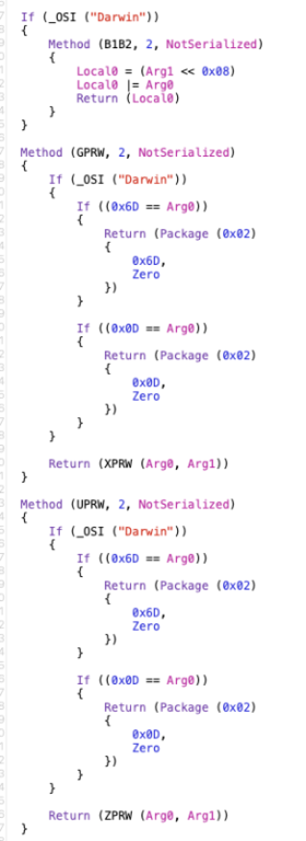

Baio77 Posted May 7, 2021 Share Posted May 7, 2021 Test this SSDT , remove all ACPI in patch Remove rename device EC0 to EC and all rename device WEG takes care of everything the real change is the introduction of Darwin for windows OS booting via OpenCore SSDT-6x0G1 Haswell.aml.zip Link to comment Share on other sites More sharing options...

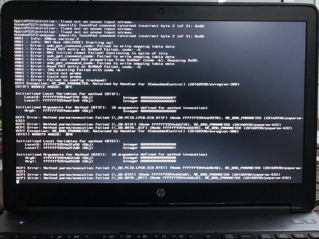

angelts Posted May 9, 2021 Author Share Posted May 9, 2021 I have issues to boot without all patch in ACPI Boot only whit patch Link to comment Share on other sites More sharing options...

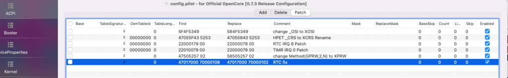

angelts Posted June 7, 2021 Author Share Posted June 7, 2021 My fresh OC 0.7.0 for test (Serial is random) EFI.zip 1 Link to comment Share on other sites More sharing options...
