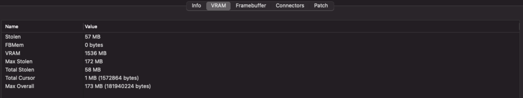

rommy Posted January 11, 2021 Share Posted January 11, 2021 Finally USB, BT and WiFi troubles have been fixed with the known limitations of non-Apple machines. I can also read the SD card appearing on the desktop as a normal USB key. I'm writing using an USB keyboard, much more comfortable. Some issues remain related to HDMI. I'm using three displays, but the only working are integrated and VGA. I discovered that now Big Sur considers it as a Display Port but it works. Monitor management by MacOS is very poor compared to what you can do in Windows10, but that's another discussion. For me it's ok to use VGA and HD monitor with the laptop display closed, so I'm investigating on how to increase video memory to make both work together. With Hackintool I get some info about VRAM and framebuffer I summarize in the attached pictures. I read max stolen 172 MB and stolen 58 MB. This last should comparable to DVMT I cannot modify in the BIOS. I would like to increase the parameter StolenMemorySize in order to reach the requested value of max stole (say to reach 192 MB). Is it correct if I compute 192-64=128 MB as a new size of StolenMemorySize to input in config.plist? This should correspond to framebuffer.stolenmem at the new value of 134217728 (11024x1024x128). This should replace the current value 00003001. Am I crazy? Hope my brainstorm is clear enough. Any suggestion or correction? Link to comment Share on other sites More sharing options...
Moderators Jake Lo Posted January 11, 2021 Moderators Share Posted January 11, 2021 Have you confirmed if the HDMI port is working...say on a monitor with lower resolution before going that route? I don't know it that actually increase it or only patches it to bypass the check. If you really want to increase it, you can use the shell to increase the value in the BIOS. Look up my guide on how to increase DVMT pre-allocation, use the search facility Link to comment Share on other sites More sharing options...
rommy Posted January 12, 2021 Share Posted January 12, 2021 HDMI works on a Samsung TV monitor 22" not HD. I can setup resolution and refresh frequency and duplicate or share desktop. Every functionality is allowed. So I think the problem is memory to allocate associated to HD features of main monitor (IPS 27") and its refresh rate (I can arrive up to 165 Hz). I found a thread named [Deprecated] Changing DVMT values in BIOS. Is this you refer to? Is it still valid? I have to boot a WINPE iso and modify directly the BIOS. Can I set up DVMT 192 MB or do I have to limit to 64 MB? If it depends on physical device I cannot set any value. I'm really doubtful... Link to comment Share on other sites More sharing options...
Moderators Jake Lo Posted January 12, 2021 Moderators Share Posted January 12, 2021 Yes, that's the guide. You should be able to set it to 192 with 0x4 Link to comment Share on other sites More sharing options...
