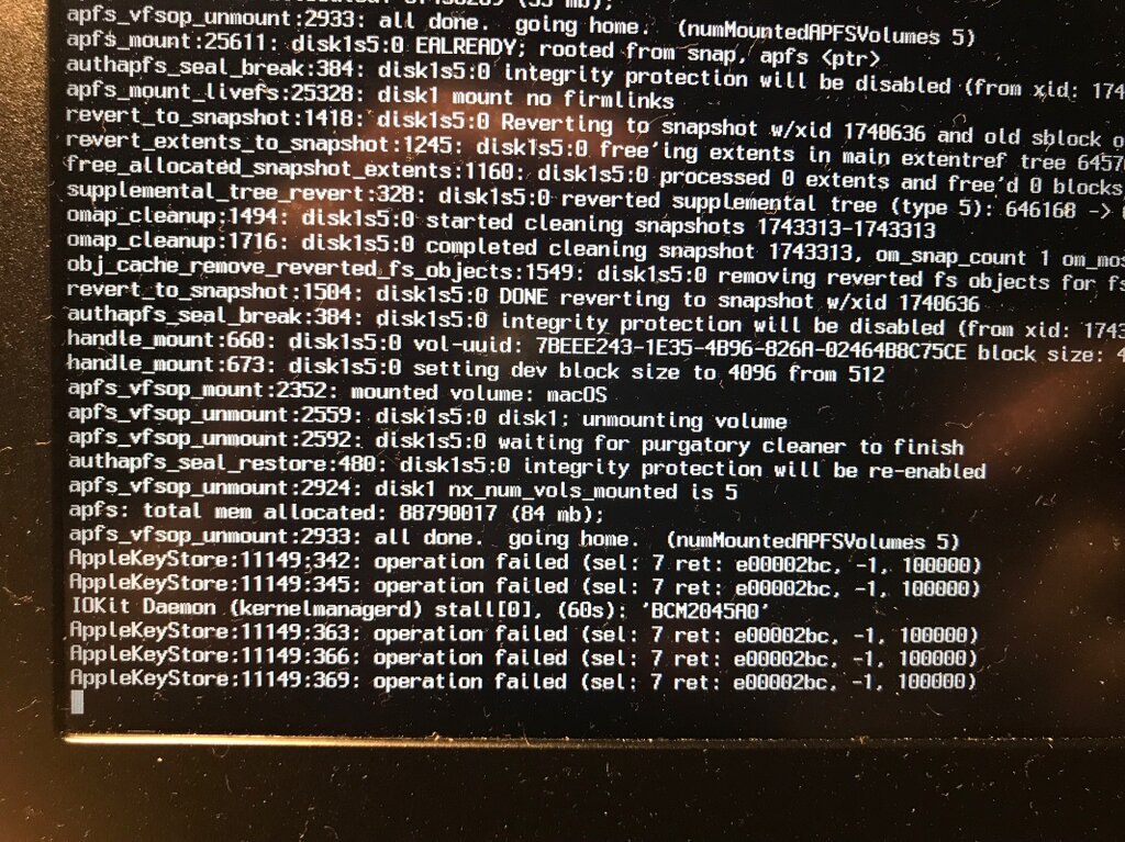

PMD Posted June 8, 2021 Share Posted June 8, 2021 My laptop failed to boot while updating to macOS Monterey version. I don't know why when I disabled BrcmBluetoothInjector in config.plist it can boot normally. How can i use bluetooth without this problem? I'm using Latitude E5470 with HD 530 and my wifi card is DW1820A. Link to comment Share on other sites More sharing options...
Administrators Hervé Posted June 8, 2021 Administrators Share Posted June 8, 2021 Bluetooth is a little buggy for the moment in Monterey 1st beta. You'll probably have to wait. Also keep in mind that, if you've kept the same versions of Lilu + PlugIns as ou used in Big Sur, you probably need the beta boot arg for all. As stated at IM, PMHeart has now updated Lilu & PlugIns for Monterey so I would advise you to update and renew your tests. Just check the usual Dortania repo: https://github.com/dortania/build-repo/releases Link to comment Share on other sites More sharing options...

Administrators Hervé Posted June 10, 2021 Administrators Share Posted June 10, 2021 My findings below. ACPI patch: you rename ECDV to EC when you actually inject the SSDT-EC-USBX table; renaming is therefore unnecessary and should be disabled/removed. you inject SSDT-HPET table yet not applying any renaming for HPET or its _CSR method. You would most likely need that for SSDT-HPET to have any effect. Device Properties: you inject SKL framebuffer layout 0x191b0000 for HD530. I would have expected 0x19160000. Are you getting graphics acceleration ? NVRAM: you'll probably have to add -lulibetaall and -wegbeta boot args to avoid system reset at boot time and KP after wake. Link to comment Share on other sites More sharing options...
PMD Posted June 10, 2021 Author Share Posted June 10, 2021 @Hervé I removed ECDV to EC patch but it can’t boot now. And how can I do with HPET? config.plist.zip About framebuffer layout, I see 0x191B0000 match HD 530 in Hackintool I updated kext to the version in https://github.com/dortania/build-repo/releases. Do I need to add those boot-args Link to comment Share on other sites More sharing options...
